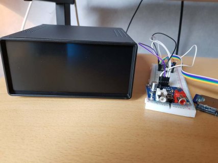

Received the metal enclosure from China.

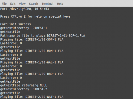

I'm currently having the problem that the FLAC file plays for only a fraction of a second. I'm investigating what the problem is.
As you can see the GetLastError() on the FLAC player object is 0 (no error), which makes it harder for me to identify the problem.
  • Teensy 3.1 and 3.2: I2S support and a single DAC pin. Note, you need to change the SPI pins if you use I2S on Teensy 3.1 and 3.2.
I couldn't get the software to work, but I now see the problem: I'm using the default SPI pins for the SD card, so the I2S doesn't work.

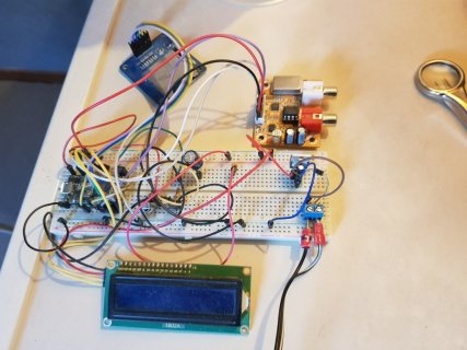

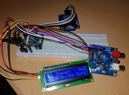

I also got me a I2C LCD display even though I already have a regular LCD display (both 2 x 16 backlit). In addition, I also got me some NPN and PNP transistors to enable me to switch off the power to the LCD and DAC board when the unit is not in use.
The software is coming along nicely, but since I'm working 40 hours a week and my weekends are mostly planned full it'll take me a while to finish it.

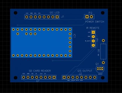

I'm also trying to put the schematics in Kicad. I'm not currently planning on developing a PCB, but that might change.

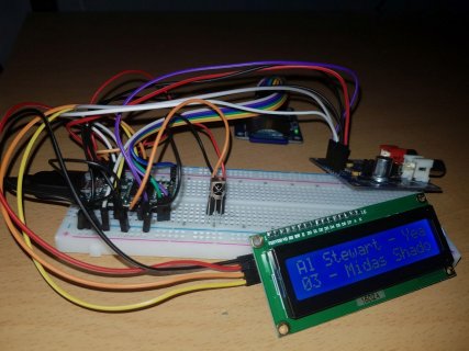

Picture of the working setup with the new I2C LCD. I'm now going to work on integrating the infrared remote receiver. I've already prepared the software to handle the commands.
After two hours of fiddling I finally got the IR remote receiver working as well. I still have to translate the codes into commands upon which the player will act, but that's certainly doable in a day's work.

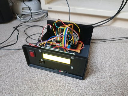

The obligatory picture of the working setup with the IR receiver.
I have to say: I'm very pleasantly surprised by the sound reproduction of the D/A converter. Probably one of the best I've heard, more so considering the dirt-cheap price.
The first two assembled PCB's.
I'll soon attempt to connect the SD card module, the D/A converter and the LCD
First working version plus the breadboard prototype it's based on.

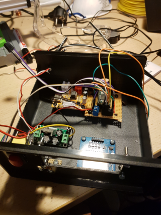

Still need to finish up some small things (power connector, IR receiver window, rubber feet).
The sound quality is exemplary. Those ESS SABRE DACs really shine.

First "production" version in use. The amplifier is a TPA3116 cheap thingie which sounds quite good.
