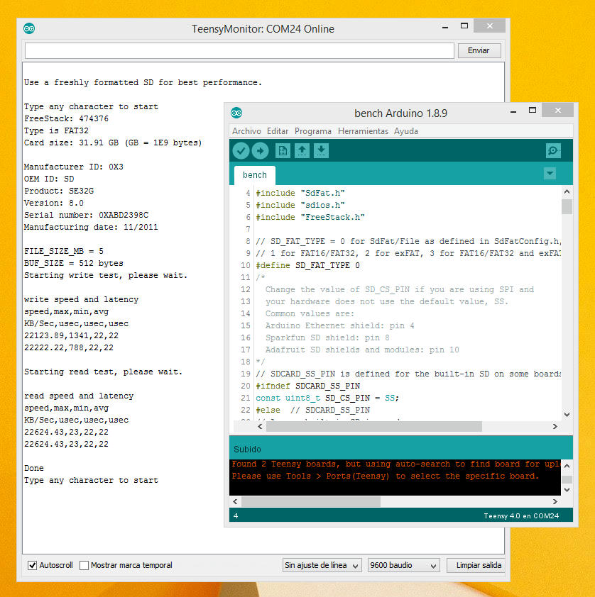

It has slightly faster read/write performance on T4 than T3 for larger transfers. This may improve in the future.
Here is the bench example for 512 byte transfers with a 50 MB file.
T4:
FILE_SIZE_MB = 50
BUF_SIZE = 512 bytes
write speed and latency
speed,max,min,avg
KB/Sec,usec,usec,usec
22123.89,4573,22,23
22123.89,4030,22,23
read speed and latency
speed,max,min,avg
22665.46,748,22,22
22655.19,1085,22,22
T3:
FILE_SIZE_MB = 50
speed,max,min,avg
18525.38,50086,26,27
18917.90,3028,26,26
speed,max,min,avg
18719.58,251,27,27
18712.57,251,27,27
