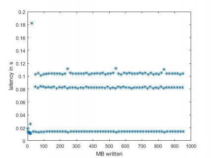

Here are some test results that show advantages of using exFAT.
The huge variation in write times for FAT16/FAT32 make writing simple data loggers that run at over about 5-10 samples per second difficult.
exFAT can improve the situation a great deal by pre-allocating a file. You can then check if an SD is busy to insure one sector will be written in less than a known time.

I ran this program on a Teensy 3.6 board using the built-in SD with SPI and a quality Samsung microSD formatted exFAT.
I used SPI since errata with SDHC prevent valid busy tests in SDIO mode. See below for SDIO timing with exFAT.
I pre-allocated a 100 MiB file.
Here is the result with waitBusy true.
Starting write of 100 MiB.
minMicros: 157
maxMicros: 161
32.79 Seconds
3197.85 KB/sec
So the variation in write time is only about four micros if the card is not busy.
If I run it with waitBusy false, I typically get something like this.
minMicros: 158
maxMicros: 1524
32.61 Seconds
3215.90 KB/sec
This means you can allocate a small sized FIFO, read data from sensors into the FIFO at the beginning of a loop and if the SD is not busy, write up to 512 bytes to the card.

Most (SanDisk) SD cards (60G/128G) I had tested, had very regular (every 16 MByte ca) a SD-delay of over 110 ms . Different disks behaved slightly different.
to measure disk performance, write to disk was raw and sequential: directly to first partition, no file system, pre-erasing had only a minor impact (some ms for largest latency), write buffer size was 16 or 32 kB with similar results.
The regularity seen may be because of a (nearly) fresh 64G disk. Only latencies > 15 ms are plotted.
I assume that used disks will have different latency pattern (see also pattern at the beginning of picture)
