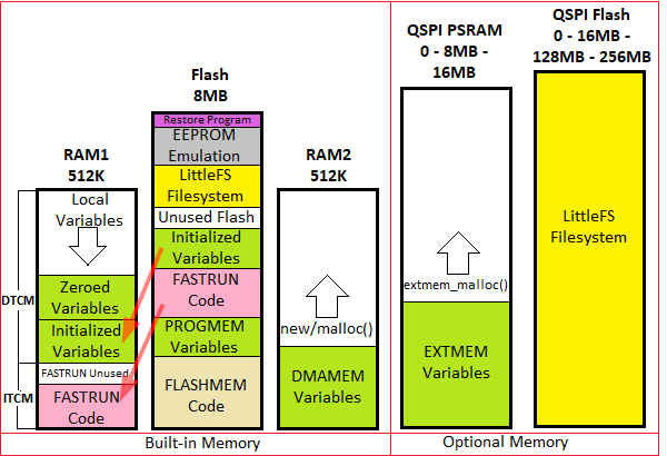

Yes, but I bought it at Protosupplies:
DEV-26-2G (8MB PSRAM/256MB Flash) has an 8MB (64M-bit) volatile PSRAM installed along with a 256MB (2G-bit) non-volatile NAND Flash memory as shown below for those that need an even larger amount of non-volatile storage such as for data logging, image files or audio files. The NAND Flash is the 8-pad WSON 8x6mm package.
The Flash chip will be a Winbond W25N02KVZEIR. The PSRAM will be the AP 6404L-3SQR or equivalent.
Edit:
After double thinking about what you said, I went back to the prosupplies site and read this:
Optional Flash Memory​
The optional Flash memory is also QSPI like the Teensy 4.1 built-in Flash with similar performance. Both smaller NOR and larger NAND Flash chips are supported in sizes as large as 256MB/2Gb using the built-in LittleFS library.
The main thing to know about the optional Flash memory is that it cannot be used to simply increase the built-in 8MB program space. While the optional Flash memory cannot be used to directly increase program space on the Teensy 4.1, it can sometimes be used to stretch the program space by off-loading large data structures and the like from program space and putting it into the optional Flash chip.
If I understand well, I have to use LittleFS to address this memory. That's not what I was expecting at the beginning, so I need further reading...
That OPTIONAL FLASH is on QSPI underside for ADDED storage of 256MB. Available for use with LittleFS.
The PJRC installed Primary Boot FLASH "PROGMEM" storage is a fixed 8MB on the T_4.1.
Sorry, I don't understand. Does it mean I have 8 or 16MB PSRAM?
This piece of code:
// Check for PSRAM chip(s) installed
  uint8_t size = external_psram_size;
  Serial.printf("PSRAM Memory Size = %d Mbyte\n", size);
prints 8 MB.
You have 8MB PSRAM and 256MB of NAND Flash that have been added to the bottom of the Teensy which sit on a QSPI bus. To have 16MB PSRAM, a 2nd 8MB PSRAM chip would be installed instead of the 256MB Flash chip. The Teensy 4.1 by itself does not have any PSRAM.
The main Teensy 4.1 Flash used for program memory is fixed at 8MB and is a separate small part that sits on the top side of the Teensy on a different QSPI bus.
As you have discovered, the 256MB Flash that has been added cannot be used as additional program space. It must be accessed via the LittleFS library. The usage of it basically parallels that of using something like an SD card.
