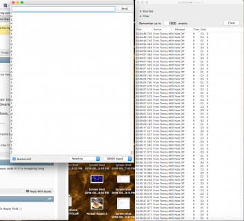

I have two Teensy 3.2's connected through Xbee in AT transparent mode, I can see commands come through on the Teensy connected to my laptop in the arduino serial monitor coming from my battery powered Teensy which has four push buttons connected using pullup resistors, but when I try to run an if else if statement from the Serial1 string the on Teensy connected to my laptop receiving the serial data in the Teensy only acts on the else if statement and only sends out the MIDI notes for usb.MIDINoteOff and it doesn't send the usb.MIDINoteOn also it is sending all three of the MIDI notes off commands at the same time, I am including a screenshot of a program called MIDI monitor it will be next to an open serial monitor that shows it is receiving the char I am sending to Serial1 I am holding the button down for a few seconds each time and each time I press or release the button for button 1, 2, and 4, in the example it sends all three note off messages for MIDI notes C3, D3 and E3. Am I using the if else statement incorrectly or is the problem possibly with the way I am reading the char data? I am lost and have been wracking my brain trying to figure out why it will not work. I have the Xbee's connected to the Teensy's in Pins 0&1 for Serial1 on both I am including the schemating for the Teensy I have that is used for note input. I running on Mac OS x 10.11.5 Arduino IDE v1.6.8 and Teensyduino 1.28 both Teenys's in MIDI board mode. I am including both sketches in this post. They will both be prefaced by bold font. I would be appreciative if anyone can see what I am doing wrong, or has any suggestions.

Transmit Working sending serial data, but receiver Teensy is sending all MIDI note offs
Receiver Teensy sketch
Rx receiving but triggering all else statements no note on
