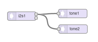

I have been working with an LM567 chip with a mems microphone. the chip listens for a narrow band of frequencies and when it hears the selected frequency it saturates a transistor and lights an LED.
I have had success lighting a green LED when the chip hears a 350hz signal from a "well bonded floor". I have also had success lighting a red LED when a separate chip hears a 1200hz signal from a "loosely bonded floor" these signals are sent as know samples of audio. However when the wand is used to scrape the floor being tested, the frequencies are a bit more erratic. So I'm wondering...
could a microphone (using the teensy audio sheild) listen for these two different live frequencies and compare them to samples in a library and report back to a pair of LED's whether the live frequency is more similar to one library sample than the other library sample?
