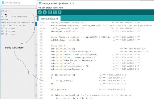

While working on getting my board to sleep and wake up, I've isolated a pretty strange behavior.
After the *second* time teensy wakes from deepSleep(), and after all subsequent wakeups, the first two Serial.println() statements have their output swapped.
I found this while running a simple test script based on the Snooze audio deepSleep_all_wakeups example. I just added some logging to it.
Here's what the output looks like before the first sleep:
Then after it wakes up again the first time, I see this (expected) output:
But after subsequent wakeups, I see this:
This happens even if I wait a good long time (2 seconds) after wakeup before I print anything.
This could be a bug in Teensy code, or in MacOS 11.2.3, or in Teensyduino, or my code, or who knows what else.
I wonder if this is a known problem, or if there's anything else I can do to help solve it. It's not really an issue for me because I only use it for logging, but I bet it's a problem for someone.
For the record, this is with TeensyDuino 1.53, Arduino 1.8.13, MacOS 11.2.3 , Snooze 6.3.9 .
