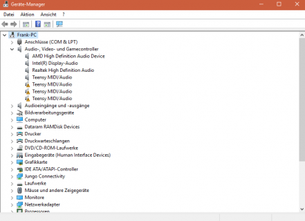

When I select USB type 'Audio', the driver loads perfectly, the Teensy Digital Audio device appears in Windows recording devices and everything works fine. The problem I'm having is that I also need a serial port. When I select USB type 'Serial + MIDI + Audio' I get four Teensy MIDI/Audio devices in my device manager 1 works and 3 have "This device cannot start. (Code 10)" errors.
When I get these errors, the Teensy Audio device is not present and neither is the serial port.
An help on how to get the USB to ennumerate as an Audio device and a serial port (I'm not using MIDI in my application), would be appreciated

I've tried it on Windows 7 64-bit and Windows 10 64-bit. The results are the same on both.
If you're getting "code 10", the very first thing to check is whether the problem also happens when you load a very simple program, like File > Examples > 01.Basics > Blink.
If the error continues with Blink, first cold reboot your PC. Then try with different Tools > USB Type settings, like RawHID or MIDI instead of Serial. If all this fails, try this Teensy on another computer (ideally, Mac or Linux running natively *not* a virtual machine hosted on Windows). It's possible, but rare, for "code 10" to actually be due to damaged Teensy hardware.
Often this error appears because something in your program is crashing before Windows completes USB enumeration, in which case you'll see the error go away with Blink. If this happens, it's time to start looking for the problem. The most common error is using Serial.print() inside C++ constructors.
If it's a code error and you can't find the problem, keep whittling your program down to the smallest, simplest code you can which still reproduces the problem. Then post it here. If using other libraries, remember to give all details we would need to get exactly the same code you're compiling.
I selected Serial - Audio - MIDI and uploaded blink sketch. Led blinks but in device manager same error appears. I try other USB types and no error (Without All of Above). My other windows machine appears same error only Serial - Audio - MIDI and All of Above USB type. I tried two teensy 3.6 and one teensy 3.2. Everything is same. Only Serial - Audio - MIDI and All of Above USB type have error.
