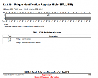

I take it that (unlike others) Freescale ARMs don't have a unique serial number in silicon or OTP memory and so PJRC had to DIY? E.g. the STM32F4's have a 96 bit unique ID.
Actually, it looks like there is unique chip serial number.
From the datasheet:
And in the reference manual, the 4 32-bit registers that make up the 128-bit unique ID are described on page 265-267:
Unfortunately, I'm not that familiar with coding C++ to access these registers.
