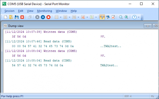

I am having an issue with serial communication on a Teensy 4.1
(1) -- When I first power the board up, I cannot receive serial characters from the Teensy with my Delphi application.
(2) -- If I close that application and open Terminal.exe , The response characters show up, but preceeded by byte values 00 00
(3) -- If I close terminal and then reopen my application , communication resumes normally.
What is causing the Teensy serial to transmit (2) null characters?

Unlikely that the Teensy is transmitting the two NULL characters...much more likely that your app connecting/disconnectng is leaving them in the RX buffer.
Comment out the while (!Serial) {}; line (which, when uncommented, will wait forever for a valid serial terminal, such as the Serial Monitor in the Arduino IDE, to "connect" . . . the function of this line of code is not just "is the serial hardware ready ??") & see if the behavior is different/better . . .

It works, Thank you
