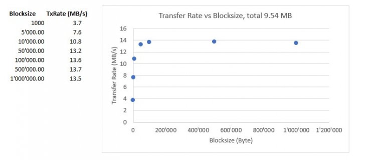

Here a measurement of the transferrate vs Blocksize from 1000 Bytes up to 1E6 Bytes per transfer block for a total transfer size of some 10MB (10x10^6 Bytes). No transmit error detected.

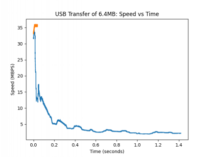

I analyzed the USB packets I posted in https://forum.pjrc.com/threads/68386-Teensyduino-1-56-Beta-2?p=290757&viewfull=1#post290757 (not sure if I should be posting here, in the 1-56-Beta-1 thread, the 1-56-Beta-2 thread, or a new thread about Serial speed -- please let me know if I should post elsewhere).
I plotted the down-the-wire USB speed vs time for both the short data transfer (0.8MB) and the long one (3.2MB). What I found surprise is that the large data set started to slow down after only 20ms while the short data set ran at full speed for 40ms. Meaning the problem starts happening before any buffers are getting full. Just knowing that there will be more bytes coming somehow makes there be a problem.
As a quick reminder, this was generated using the original firmware posted at the top of this thread and under Linux. There are no data errors, but the transfer speed as you can see plummets. I believe the same problem happens in Windows, however, other Windows bugs make it less clean an environment to look at the data.
Ok, sorry, please ignore the previous post's data -- I accident used the wrong data set. Here's data that shows the (somewhat averaged) instantaneous data rate vs Bytes sent for two sends: 0.8MB and 6.4MB. I've reported it both with the OS measuring the timing and by looking at the USB packets down the wire. Now all the data is about the same -- how the timing is measured does not make much difference and sending a smaller file follows the speed curve as sending a longer file.
P.S. In the previous graph, I was showing two different runs with a different amount of data sent.
This is just speculation, but I wonder if once some buffer fills up, the Teensy waits until it can send more data, but as soon as it can, it sends a small amount, and then sends another small amount since that's all that's empty in the buffer and these small transfers aren't efficient and if it we were to just wait longer and then send a long burst, it could be much more efficient. And then luni's solution of requesting the data in chucks effectively is doing this delay.

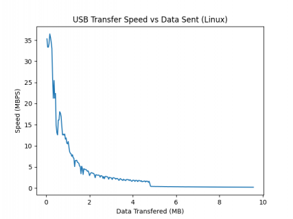

I took a longer data set and there is a sudden change in rate at 4.8MB (this number is not consistent shot to shot -- sometimes it happens at 5.5MB for example). I've attached plots on both linear and log scales to show how slow the data rate gets. At the end of 9.5MB, I'm getting 0.2MBPS, but it is still dropping exponentially (linear on the log scale).SpeedDropOverTime.pngSpeedDropOverTime-LogScale.png
For completeness, here are the same plots, but tested under Windows. Some data was dropped / corrupted, but I just ignored it. The weird discontinuity at ~5MB is gone, and the rate dropping isn't as clearly linear on log scale, but the general shape and speed is about the same with the data rate going to 0.2MBPS after 5MB or so.
In Linux, I need to do my Serial.writes in a loop with 2048 bytes per write or else I get dropped data. In this Windows data, I kept that, but I found that going to 4096 bytes per send is better in Windows -- it stretches the x axis a bit so it sends at higher speeds for a little longer.

Well, this is super embarrassing. You are 100% correct and I've been chasing my own tail. I stopped storing the data and I can hold 32MBPS throughput for 100's of MB with no slow down. I added functionality to test if the data is right (per packet, not at the end, so still not storing large data) and in Linux with a 2048 writes, I get no data errors and ~16MBPS for any size of data. I'm sure that 32 -> 16 MBPS is from my python code checking the data in the loop. So that's great.
So, Linux works 100% as desired / expected with reading the data in packets of size 2048 bytes or less. (2048 maximizes speed, but that too may be an artifact of my code since it does more data checking with smaller packet sizes). I went to 4096 byte packets and I get data errors. Somewhere between 3800 and 4000 bytes seems to cause a problem. Not sure what's going on there, but receiving small(ish) packets isn't hard. (And that may be a python / pySerial bug)
As for Windows, other data corruption bugs prevent me for testing the data integrity, but the speed is basically the same: 32MBPS if I don't test the data, 16 MBPS if I do (and ignore it, since it is often bad).
Again, sorry for all the distractions, all the speed stuff was an artifact of my code. Good catch Luni!
