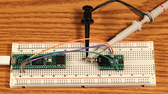

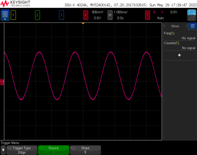

I believe there was a AudioOutputPT8211_2 bug in version 1.55. Any chance you have 1.55 instead of 1.56?
Could also be a wiring problem. I know you already double checked your wiring, but if you show us more photos (so we can actually see the wiring) maybe we'll notice something?
As I said, engaging any of the "i2s_quad" connection makes this work, and there are no other pins connected yet, so it does work... but only in conjunction with one or more of the other i2s ports ALSO being connected in the sketch.
Clicking help>about does indeed reveal teensy 1.56.
I really appreciate help on this. I'm a bit over my head with these libraries, wish I could just throw some fresh code at it and try it.

I tried but could not reproduce the pt8211_2 issue.
I connected a PT8211 board to pins 2, 3, 4. Here's a photo of the hardware I tested.
I ran this code, basically the same as msg #24 with extra stuff trimmed.

This is the waveform my oscilloscope sees on the output.
I tested with both Teensyduino 1.56 and 1.57-beta1. Same result with both. I get this sine wave on the output when running that simple program which uses only AudioSynthWaveform and AudioOutputPT8211_2.
I don't get it. Thanks for your help, this one has beaten me. I still get nothing when I try your sketch, and my system is pretty much a bare teensy and a dac. I do have two 8MB ram chips installed. Any chance that could be having an effect? The ram passes the ram test.

If you give me code to try, I can run it here on the Teensy 4.1 and PT8211 on the breadboard and capture the output with my scope. Ultimate the compiler creates a HEX file with is the actual data that gets written into Teensy's flash memory. You could give me both the source code and the HEX file and I'll try both.
So far I have no idea what's going wrong here. I do want to get to the bottom of it. Please try to focus on giving me a way to reproduce the problem.
