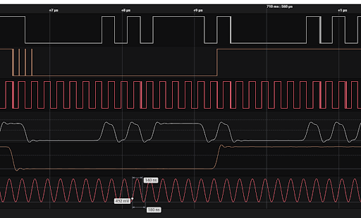

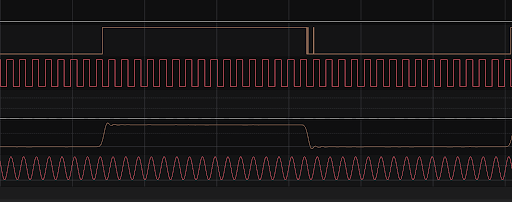

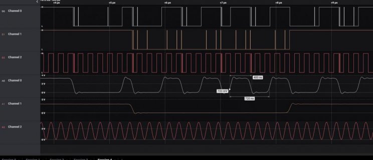

For what it is worth I downloaded the sketch #52 and built it on Windows 10. Note My Audio library is github synced to what is currently checked in.
I hooked up Logic Analyzer to pins 2-4 and ran it and show both the digital values for each pin as well as what it thinks the analog value is.
Note: I did get a few compiler warnings:

Using a multimeter on pin 2 tested the following (1.57b1+):
DUAL SERIAL - OK
SERIAL - OK
SERIAL+MIDIx16 - OK
SERIAL+MIDIx15+AUDIO - OK
RawHID - OK
@KurtE attached a LA to and tested with DUAL SERIAL as well.
Without the change pin 2 is flatlined:
with deleting FLASHMEM from in front of config_i2s
If someone can test the change with actual h/w since I dont have a PT2811 soldered up it would be good.
