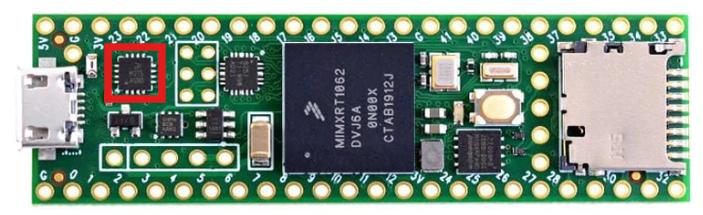

Hello everybody,
I have a problem with my Teensy 4.1 board. Today, while i was trying some codes with RC servos, one analog signal wire was touched to servo's GND or +12V mistakenly and caused short circuit. Now, my teensy board does not run. When I energized it via USB, marked component with red rectangle below is becoming hot. What is this component? Any idea? Is it possible to repair it ?

That part is the voltage regulator. It gets burning hot when another part of the board is shorted (from 3.3V to GND), because the rest of the board is trying to consume nearly limitless current and the regulator tries to work as hard as it can to supply that current.
I'm afraid the news is only bad.
Sometimes a 3.3V-GND short on the board is recoverable when the problem is stray metal, like excess solder. But when the 3.3V-GND short is inside a chip, repair isn't feasible. If you have a voltmeter, you could try measuring the DC voltage from 3.3V to GND. If you see a low number but not close to zero, like 0.5 to 0.9 volts, that's a pretty sure sign the short on your board is a semiconductor short. Metal shorts read zero or only a few millivolts.
Sadly, we've seen this many times with 12 volt projects. Accidentally touching 12 volts to pretty much anywhere, even for only the slightest moment, completely destroys the main processor. It's a sad moment to lose hardware, but at least you can avoid wasting a lot of time on attempting repair and just replace the entire board.

Thank you very much Paul. When I measure the 3V-GND pins DC voltage, I saw that 0.08 V. It is almostly closer to 0 VDC. So do you have any comment about it?
That is pretty close to zero. If you didn't know what went wrong, and especially if the problem had appeared right after soldering pins or doing some other mechanical work where stray metal may have been placed on the circuit board, I would have normally have suggested looking for a metal short.
But you do know what happened. Accidentally touching 12 volts isn't going to make metal magically appear. But it definitely will burn the inside of the main processor. We know this with good certainty because it's happened many times with people building 12 volt projects. The result is always the same, the U1 chip destroyed.
I know it's bad news, but hopefully not as painful as wasting a lot more time trying fix something that has virtually no hope of repair. It's time to just replace the damaged hardware.
Probably not very comforting, but plenty of other folks working with 12V have had similar mishaps. I've even done a couple times. Usually after something like this happens it's a good idea to think about connectors or cable (zip) ties or other ways to keep higher voltage wires secured while working on the hardware. Just 1 brief errant moment is all it takes to completely destroy the main chip.

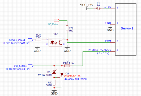

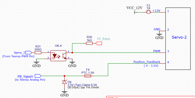

Thank you @xxxajk . I designed 2 diffrent circuits below. PWM signal protecitons are same for both of them with optocoupler. But for the analog signal pins protection, 1st one was made according to your protection circuit advice. Components are not totally same with your circuit since I could not find same in here. So I have to changed them with alternatives which are existing in here. I am not sure if they run normally or not. :)
2nd one is my own design with TVS diode. Could you check them please? Do you have any suggestion or idea? I dont want to waste my microcontroller anymore :D

You can do analog by using an opto isolator that has PIN diodes and an opamp.
Basically it allows you to do analog "level shifting" of sorts.
Also the PTC is on the wrong side of the circuit...

Thank you @xxxajk . I tried to use 817 optocoupler component on my PWM signal line. Not worked. May be frequecy is not enough. I will try high frequency types.
Feedback signal voltage comes from Servo to analog pin. So when the voltage exceed the protection limit, short circuit will be. To protect line, I should cut voltage by PTC. So it should be on line voltage source side. Am I right? If not, could you explain its logic please?
The idea for the PCT is for voltage supply to the MCU, not as an input.
For analog signal input from something not in the 3.3v range, you want to optically isolate using an optoisolator with analog compensation PIN diode.
VOA300-DEFG-X017T and the IL300 are interchangeable, I've used both with the following circuit. Select the one that best meets your timing requirements.

Other notes:
You shouldn't need anything faster than 1MHz ability for PWM.
The PTC circuit is meant to protect the MCU power supply, it does not reset unless powered off.
The idea is to short an over voltage source to ground, and the PTC takes the abuse of the short circuit that is protecting your MCU...
For example, plugging in 12V into a 5v circuit because you grabbed the wrong adapter.
