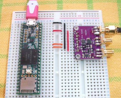

The Si5351 Clock Generator chip has several excellent mentions in this forum previously, but I wanted to create a very simple design that anyone can put together in a few moments with a breadboard. This article is really a simple "How To" for beginners. Lots available on eBay. Here is what I produced.
Its a signal generator (sq waves only) that can be set from 4 KHz through to 100 MHz (with 1 Hz resolution if desired). The high frequency end extends beyond 100 MHz but above this figure my scope runs out of bandwidth, and I'm interested in measuring true amplitude settings for testing RF transformer designs.

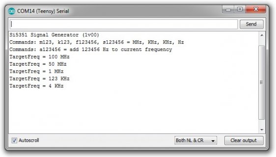

Only four wire connections need to be made +3v3, GND, SDA, and SCLK, as shown in the left picture. I use the Arduino IDE serial monitor as command input control shown in the right picture. This picture also lists the commands available e.g. m100 will set to 100 Mhz etc.

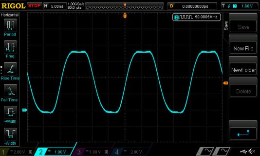

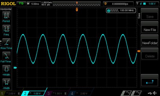

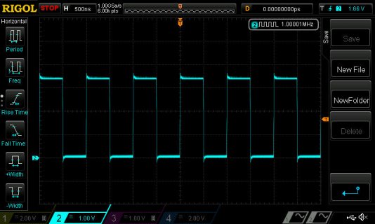

To illustrate the outputs, I include the following set of screenshots. The frequency counter reads high by 1 part in 10e5. I'm only using CLK0 of the three available outputs. There are some limitations on the simultaneous settings for the others (CLK1, CLK2) - see the data sheet for more detail.
As you can see, the amplitudes are really superb at almost a full 3.3 volts over the whole range. The output driver is HCSL (High Speed Current Steering Logic). There is also a feature to correct for drift/offset of the onboard 25 MHz master crystal in parts per billion. This will be temperature dependant but does take out most of the variations in clock crystal components. I have also used the higher current drive setting to get more drive into capacitive loading at high frequency.
