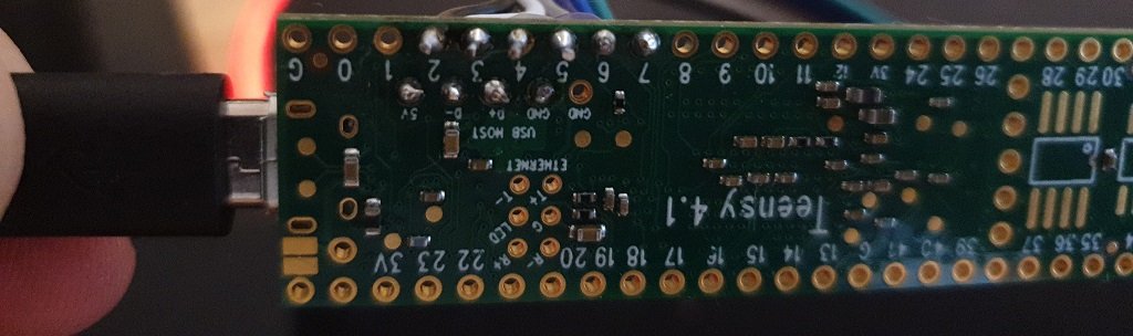

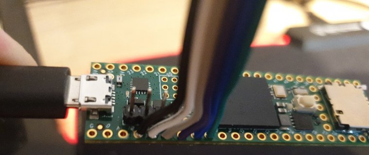

Hi There,
i just registered to ask a question,
i have a problem with my first Handwired Keyboard.
whenever i push a key it also sends the key in the row above, i have watched several images of keyboards and i am nearly sure it is not the diode direction i got wrong, i probed every cable for shortcircuits but could not find any,could someone have a look and point me in the right direction?
the code is for a teensy 4.1 derived from one here on the forum, it coundn't be much simpler.
but still whenenver i press "q" or "a" i get "qa" if i hold "q" or "a" i get "qaaaaaa"
i just want nkro to work :-(
