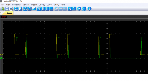

After some found out, I followed the post of another member that was very useful(https://forum.pjrc.com/threads/61758-Polarity-Inversion-for-Teensy-4-0-FlexPwm?highlight=pwm+invert) He uploaded the function void flexPwmInvertPolarity(uint8_t pin, bool inversePolarity) from pwm.c. Then when I run it, the two generated PWM signals, at the end momentary they are all High logic Momentary High.jpg .What I need, is little help how to configure the microcontroller to complementary channel operation and insert dead-time so when applying to the hardware doesn't damage the mosfets.
Also I found on the datasheet of teensy 4.0 that I need to set dead-time registers DTCNT0 & DTCNT1, complementary register CTRL2[INPEP]=0 and MCTRL[IPOL] for output on PWM23 or PWM45.

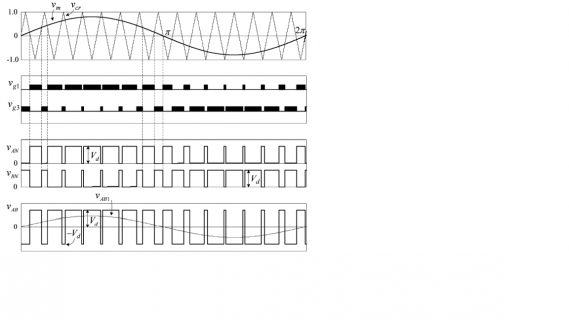

To drive the mosfets I am using bipolar topology applied for motor inverter (http://www.ijirst.org/articles/IJIRSTV1I7111.pdf). My aim is to produce pulses as described in the pdf link to drive the mosfets at 10KHz PWM and the result across the inductor(motor) we will see a sinusoidal current waveform. As we can see the screenshotbiplor modulation.png Vg1 and Vg3 must be in antiphase and I need to introduce little dead-time because when I applying in the mosfets( S1&S3 or S2&S4) they cannot be dead short momentary and the worst case can be damaged . I am seeking code snippet example how I could be able using Arduino ide to program the Teensy 4.0 because I am not too much familiar to set the correct registers.
Thank you in advance for your advice,
Saviour
That's synchronous rectification by another name - two switches on, two off, all the time (apart from deadtime).
Neither are great names for what is more simply just antiphase drive.

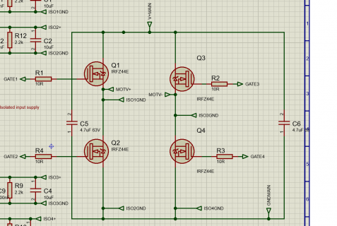

To confirm if it is synchronous rectification please attached my hardware circuit.

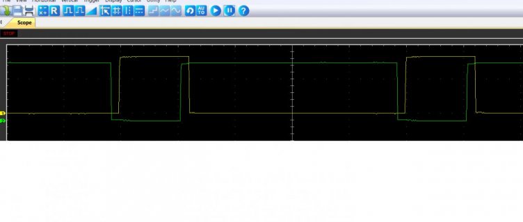

I drafted a program to produce 1HZ sinewave with antiphase drive, the gate pulses of PWM0(inverse) and PWM9 as I said earlier at the end overlap(momentary high logic) see image
Momentary High.png.

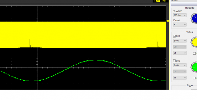

To confirm the output that is correct, I fed one of the PWM signal to a low pass filter to see the 1Hz sinewave.
sinwave.png.
