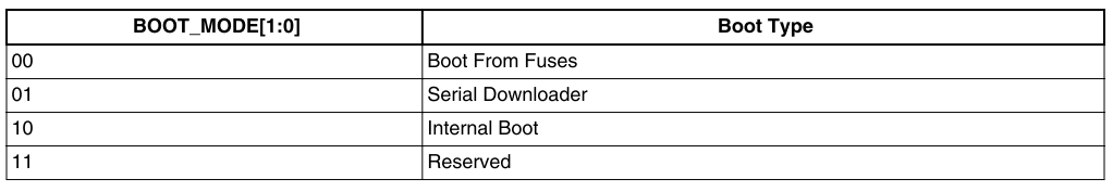

Another hint, the pin AD_B0_04 [F11] is the BOOT_MODE0 input which shoud be at GND to boot from Fuses, or rather not from serial.
