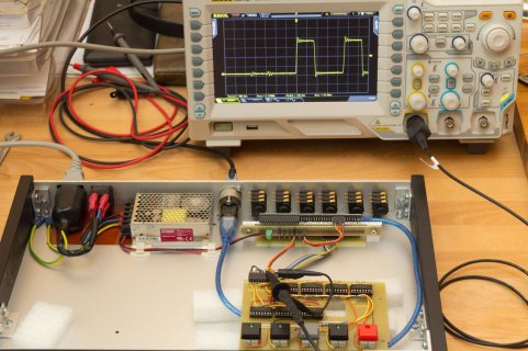

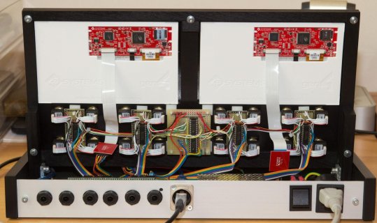

Using an oscilloscope I performed some tests to see whether the delay is actually required. The test setup (alle delay statements removed and clock inhibit connected to ground) is shown in the following picture:
The stripboard contains four 74HC165 shift registers for the buttons and three 74HC595 shift registers for the leds, the other buttons are on two separate boards. Alle the IC sockets have 100nF decoupling caps build in. A Teensy 3.6 is mounted on a Tall Dog extension board, it is mounted on its side for easy access to all the pins.

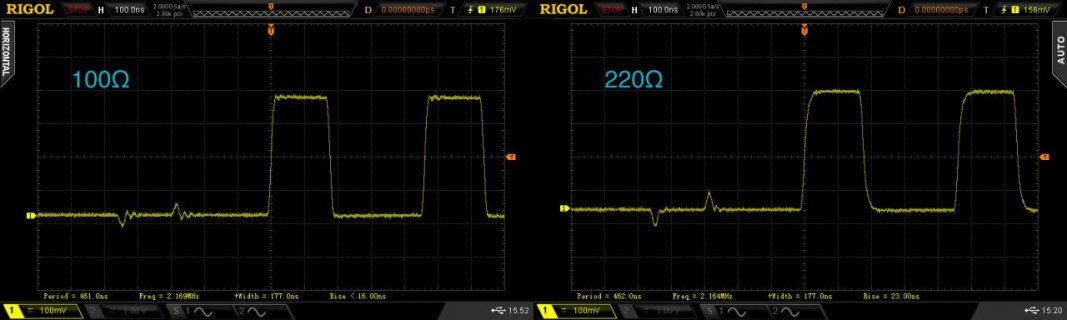

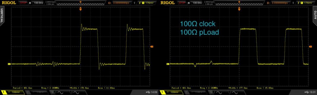

I'm no electrical engineer but this looks like a decent clock pulse to me. Here's a screenprint showing the clock measured at the last IC in the chain:
The clock frequency is just over 2MHz, pulse width is about 175ns. From the datasheet:
Worst case is a maximum of 6MHz and a minimum pulse width of 80ns so we're well in the clear. No need for any delays in the code.
The code running in the test:
