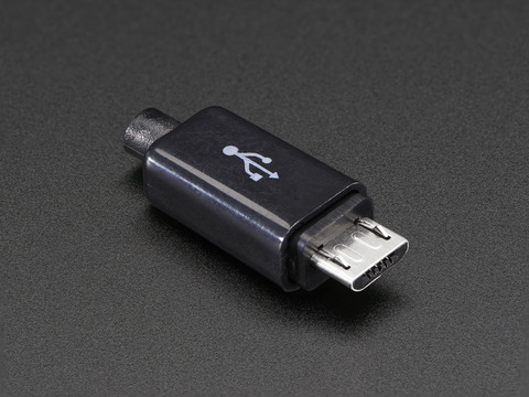

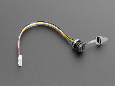

For what it's worth my plan for my current build is to use a panel mount USB C:
and wire it up to this micro usb plug internally:
That way I can make the connection wire as short as possible. I don't expect a lot of shuffling around inside the enclosure so it should be secure(ish).
