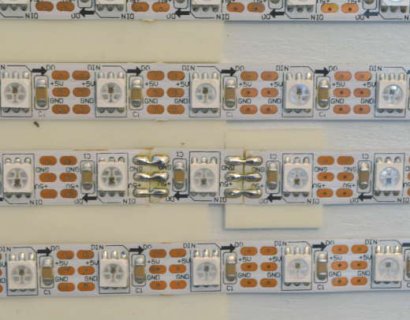

My main advices is this: buy spares.
This photo pretty much sums up my experience.
I have over 30m, of 60 led/m ws2811 strips... I've only lost one pixel..
