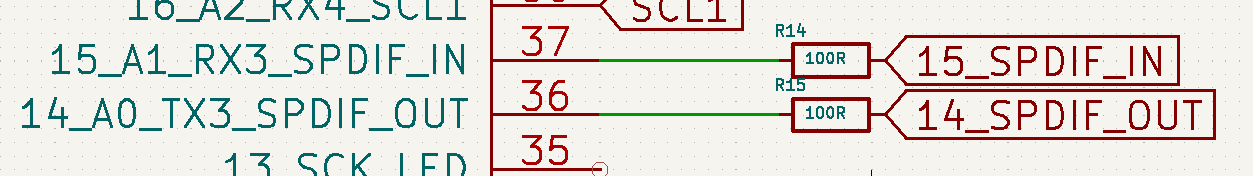

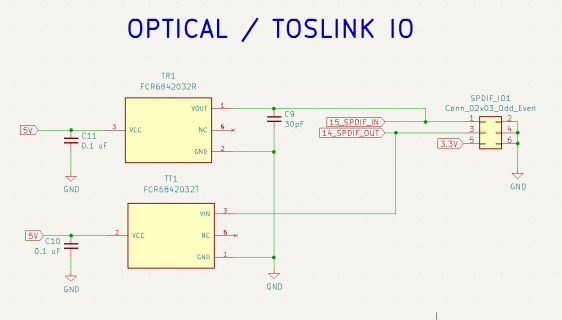

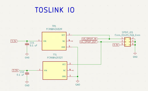

Can someone please verify the schematic below looks like all we need to successfully implement an Optical / TOSLINK IO with T4.1 (other than software)?
Using FCR6842032R and FCR6842032T made by CLIFF Electronic Components Ltd.
Frank Boesing has linked to some TOSLINK / SPDIF circuits on his github page. I will quote him below to contribute to the discussion/documentation here.
I'm also going to link to the design tool below.
https://www.pjrc.com/teensy/gui/?info=AudioInputSPDIF3
https://www.pjrc.com/teensy/gui/?info=AsyncAudioInputSPDIF3 <- pin 15
https://www.pjrc.com/teensy/gui/?info=AudioOutputSPDIF
https://www.pjrc.com/teensy/gui/?info=AudioOutputSPDIF2
https://www.pjrc.com/teensy/gui/?info=AudioOutputSPDIF3 <- pin 14
If done correctly, it seems that optical is easier to implement than SPDIF. I think optical might be cheaper because of the transformer and/or buffer drivers. I imagine optical is almost as ubiquitous as SPDIF? An external converter is pretty easy to come by if not, I think.
Can someone please verify my optical jack schematic? Also, will this work with ADAT?
