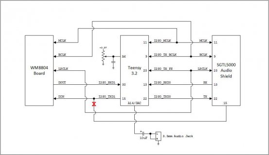

Hi all. A while back I was working on an audio-reactive LED project. Because of the physical location, the most convenient way to bring the audio to the Teensy was via an optical SPDIF connection. I started working with the TI DIR9001 mostly because it’s available on a preassembled eval board containing all required components for Optical SPDIF --> I2S conversion. You just connect power, the optical input, and the I2S signals. I posted the resulting code in this forum
The main drawbacks of the DIR9001 are that it’s unidirectional only (it can’t do I2S --> SPDIF) and the eval board is ridiculously expensive.
Then I ran across the WM8804 from Cirrus Logic. This device solves both of the above problems as it is bidirectional and there is a very reasonably-priced board available.
So, I created several new classes based on the Quad I2S classes in the Audio Library. The major changes are accommodating a BCLK frequency of 64 * Fs and support for Teensy to operate in I2S Slave mode. The library code and two examples are attached. The connections supporting the examples are:
As when using dual Audio Adaptor Boards, you need to disconnect Teensy Pin 15 from Audio Adaptor Pin 15. Otherwise, the bypass cap on the later kills the high frequency IS0_TXD1 signal. I cut the pin, you can probably also just remove the cap.

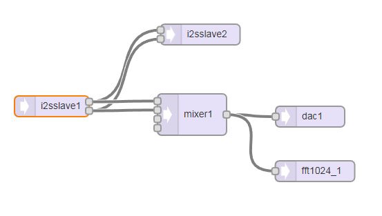

OK Paul, by removing the Audio Adaptor and connecting the WM8804 EVB to TX_BCLK, TX_FS, I2S0_RXD0, and I2S0_TXD0 the new 64-bit I2S Slave classes worked as expected. The WM8804 was I2S bus master with timing based on the supplied Optical SPDIF signal. The T3.2 received the audio and sent it back out to the WM8804 (for I2S --> Optical SPDIF conversion) and to the Teensy's onboard DAC.
Here's the Design Tool setup:
Here's the sketch:

Note that I used a modified version of the AudioOutputAnalog class to run the onboard DAC. It triggers the DAC's DMA operation from LRCLK (aka FS) rather than the Teensy's clock. That way it stays synchronized with the audio from the WM8804. Here are the .h and .cpp files:
