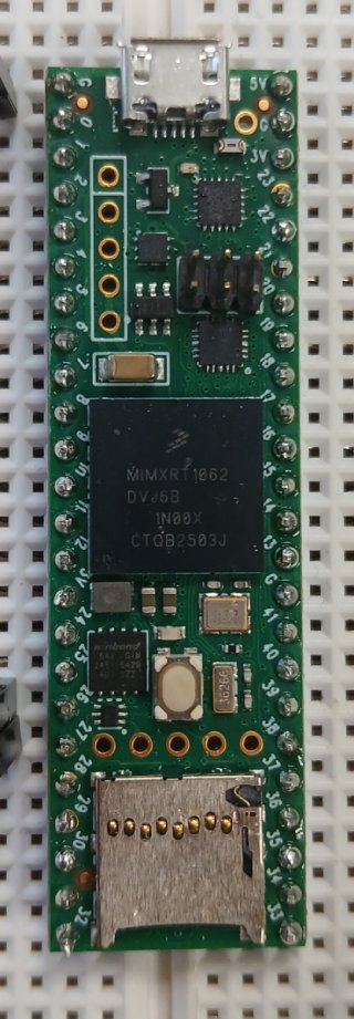

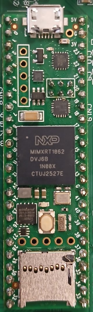

I didn't pay attention to this at first but since I have so many issues, I wanted to rule out everything. When I took a closer look at the PCB I noticed something strange. Somehow the 2 versions are different!?!?
My original on the breadboardThe new on the PCB
I get this from an external supplier (build and soldered). Does anyone have any clues on what this could be?
My breadboard version has the freescale logo (as does the one on the store https://www.pjrc.com/store/teensy41.html), but the PCB has the NXP logo?!?!
Sorry for all the new posts, I'm just trying to keep everything separated by topic.
It's exactly the same chip. They just changed the logo.
NXP acquired Freescale Semiconductor in 2015. But they waited 10 years to finally change the logo on the chips Freescale made, even ones that were released a few years after the merger. The main reason for the delay was because Qualcomm made moves the acquire NXP in late-2016. But by mid-2018, the Qualcomm acquisition fell through. The main obstacle was lack of approval in China. No official reason was ever given (as far as I know) but it was widely viewed in the context of worsening international relations due to new tariffs from Trump's first presidency.
Then on the heels of the Qualcomm deal falling through, whole world suffered shutdowns and then supply chain disruptions from the Covid-19 pandemic. As the pandemic eased up, NXP's main focus was their (then) new MCX microcontroller product line, which combined stuff from NXP's "LPC" and Freescale's "Kinetis" microcontrollers.
Finally in early-2025 they got around the updating the logo from Freescale to NXP. The change is only the logo printed on the chip. Inside it's the same silicon.

Here's the hardware on my workbench, so you can see how I tested and where the scope probes connected.
