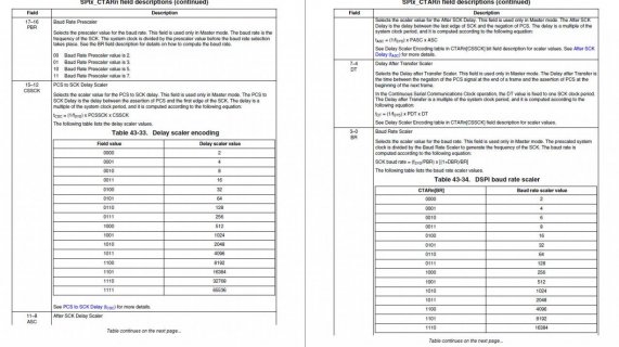

Hello,
Still a little bit new to the bitmath stuff. Just trying to find out how the following macros(from mk20dx128.h) correlate to the attached datasheet for the Teensy 3.0 chip. These are the questions I am trying to answer:
If I set SPI_CTAR_PBR(0) the Baud rate prescaler will be ?
If I set SPI_CTAR_PBR(1) the Baud rate prescaler will be ?
If I set SPI_CTAR_PBR(2) the Baud rate prescaler will be ?
If I set SPI_CTAR_BR(0) the the Baud rate scaler will be?
If I set SPI_CTAR_BR(1) the the Baud rate scaler will be?
If I set SPI_CTAR_BR(2) the the Baud rate scaler will be?
Can anyone let me know? Or let me know where I could learn about how these are set?
