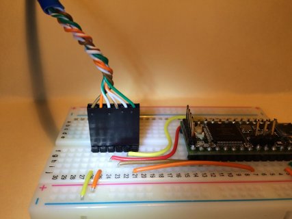

Photos enclosed. PJRC board is A Teensy 3.2. The IMU is a LSM9DS0 chip on a Sparkfun breakout board (https://www.sparkfun.com/products/13339). The IMU board and wire harness (3 feet in length) were SPI and I2C tested on an Arduino-Due, so the wiring works. The order of the pins from left-to-right are: GND, VDD, MOSI, SCL, MISO, and CS (https://learn.sparkfun.com/tutorial...up-guide?_ga=1.29217596.1274800483.1464756633).

Sorry, I may be completely off, but looking at your photos, it looks like you are running AGND (Analog ground) to the sensor. Have you tried running one of the GND pins instead? Not sure how much of a difference it would make.

Back to the Teensy, I'll use the normal ground. But I think I found the problem: it's my wire harness. The two ends are not identical. The breadboard end is ordered to match another project. I'll check it tonight. Thanks for your help.

On close inspection it may be that White_Orange and White_Brown are swapped.
The photo makes it appear that way, but I checked it closely, and the wire harness is okay after all.
