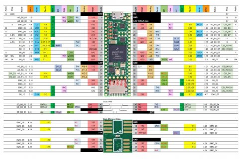

Those pins when used for QSPI PSRAM or FLASH are not using the SPI2 bus at all. They map direct as QSPI devices with FlexSPI hardware pin function from the 1062.
If the FRAM can do QSPI it may map - but would take different setup. If those pins maps as SPI2 ( need to print the KurtE card back ) it would take wiring connect and setup as needed to do that device.

is this impacted if SDIO (42,43,45) is being used? On KurtE's card these are also labelled MISO2, MOSI2, SCK2.
Yes - SPI2 are both on SdIO pins as well as the underpin with memory chip foot prints.

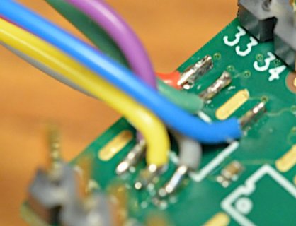

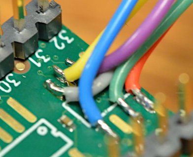

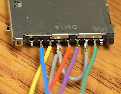

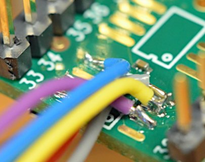

I wired it up here, just to make sure SPI2 really does work. It does indeed.
Hopefully these photos can answer the question of how to physically connect a SD card to SPI2 without using the SDIO pins on Teensy 4.1's built in SD socket.
(click on any of these images for full size)
This is the exact code I ran.
const int chipSelect = 52;
  SPI2.setMOSI(50);
  SPI2.setMISO(54);
  SPI2.setSCK(49);

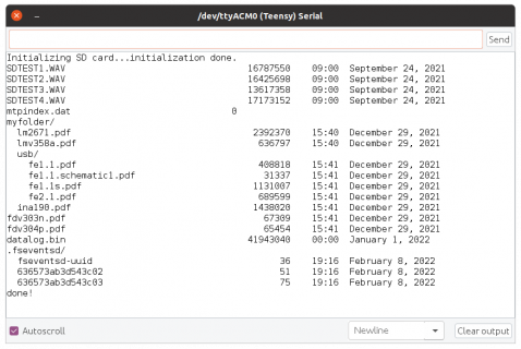

And here is a screenshot of the result in the serial monitor.
