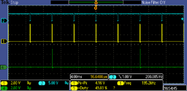

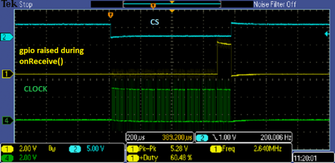

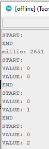

Has anyone had any luck using a master and slave from the same device? i.e. preferably using a teens4.1 SPI as master and SPI1 as slave? or vice versa?
I had it working with two teensy4.1 talking to each other over SPI but struggling to get it working on the same unit.
In this instance I am using SPI1 as the Master but as soon as uncomment
// mySPI.onReceive(myFunc);
// mySPI.begin();
It stops printing out the data being sent by the master
// mySPI.begin();
