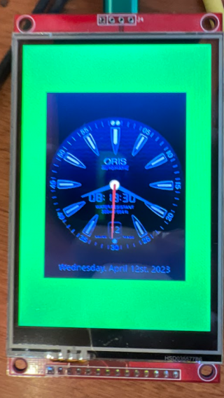

Another quick update:
I have the crazy clock running on the ST7789 320x240 size.
All I changed was the header files.
#define USE_ST7789
// This example runs on teensy 4.0/4.1 with ILI9341 via SPI.
// the screen driver library : https://github.com/vindar/ILI9341_T4
//#include <ILI9341_T4.h>
#ifdef USE_ST7789
#include <ST7735_t3.h> // Hardware-specific library
#include <ST7789_t3.h> // Hardware-specific library
#else
#include <ILI9341_t3n.h>
The object defines:
#ifdef USE_ST7789
ST7789_t3 tft = ST7789_t3(TFT_CS, TFT_DC, TFT_RST);
#else
ILI9341_t3n tft = ILI9341_t3n(TFT_CS, TFT_DC, TFT_RST);
and the init/begin:
  #ifdef USE_ST7789
  tft.init(240, 320);  // Init ST7789 320x240
  #else
  tft.begin(SPI_SPEED);
Two of my Micromod boards, one with ILI9341 mounted on back and the 2nd with ST7789 on front

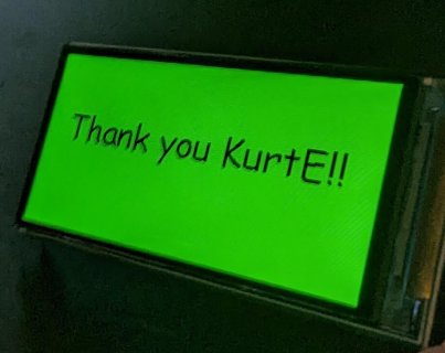

Bolimpa, were you able to get the 1.9" 170x320 screen working? I also have it. It works with the Adafruit library but not with the Teensy ST7735/ST7789.
Kurt, would you happen to know what I would need to modify to get the 170x320 resolution working?
Probably.
We need to change in ST7789_t3.cpp/.h, the init method as well as the setRotation, and make it a little more generic, like Adafruit did.
That is init needs to define where the start row, columns are, and they define two sets instead of 1 such that the setRotation can use the 2nd set for two of the orientations, instead of trying to compute it...
I will try to do a quick update later this morning, when I am more awake
That's awesome! I did see the difference in the init in the adafruit code but wasn't sure how to make it work with the existing code. If you can make an update that would be really, really great. Thank you!
