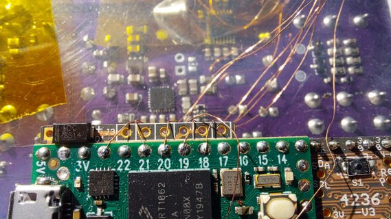

Also hacked one of my ESP32 boards with ES8388 to make a driver for it. Unfortunately it oscillates as the SGTL5000 with the high gain sounds. I hoped the diff ADC input + input noise gate will help, but i'm having problems with getting it to work. Might be also a layout related, this board was not designed for gain-domain effects. The new hardware using AKM AD/DA will be.
I followed Steve's suggestions and I'm now getting better results out of my TGA mkII board. Doing the offset calibration after a few minutes did the trick.

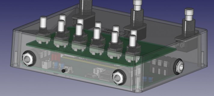

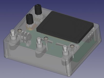

Hardware platform is in the works, i'm trying to make it versatile and mod friendly:
  • Teensy4.1
  • AK5552 + AK4552
  • ADC+DAC can be replaced with a separate module containing a codec + whatever it needs. I2S, I2C, differential ADC input and single ended DAC output are provided as pads. If the DAC has balanced outputs, the receiver will have to be on the module.
  • GUI via ESP32S3+Touchscreen. ESP will control the Teensy via I2C1/slave. I'll probably make some kind of midi over i2c
  • 3 Footswtich inputs, they are also routed to the ESP32 connector.
  • 3 optional Pot connectors
  • Output analog volume control.
  • External Dry/Wet mixer + bypass using JFETs, they can be slowed down and crossfade signals instead of rapid switching - less clicks.
  • Almost all Teensy GPIOS are routed to two FPC 20pin conncetors - this way any other means of control can be added instead of the touch screen. I2C, SPI are available there, a few ADC inputs and 3V3 power.
  • Power input is 9V DC, 5V high current digital supply (Teensy+ESP32) using a switching step down regulator. Low noise analog 5V for the input circuit, ADC and DAC. Output analofg section has a bit higher headroom - powered from the heavily filtered 9VDC.
  • Input signal presence LED + clipping indicator.
  • Will try to add more leds, maybe one over each footswitch.
  • Fits into the 1590XX/1790NS diecast alu enclosure.
  • 4 layer PCB
Man you're moving on fast :)
  • 1590XX is propably good choice as it's fairly common Hammond enclosure. And aluminium will provide shield.
  • AK5552 looks like very high quality adc but for AK4552 I only found some obsolete part from Digikey and datasheet from 2001. Maybe you mean AK4452 dac which seems like quality similar to AK5552? Those numbers are so confusing :|

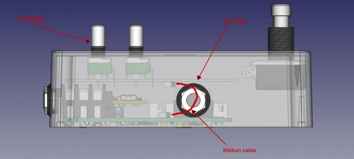

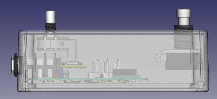

  • There is one pot on 3d image that looks like output volume pot? I built pedal in 1590A enclose (that smallest Hammond) and I put connectors on bottom side of PCB and small Alpha 9mm RK09 pots on top side. With those pots height was not too much and I was "just" able to fit it in that box. 1590XX is slightly higher (3mm) so you might be (maybe) able to do the same thing to give you some more freedom for part placement. That pot looks like it's still trying to find it's place so maybe this is something you are working on.
  • maybe possibility for external expression pedal would be cool to control reverb time, modulation speed, delay time or something else by foot.
Good stuff!
Diecast boxes are pretty much standard for the stompbox builds.
AK4552 vs AK4452 - of course that was typo, i mean the 32bit 4452.
The volume pot will fit, tested many times in practice, the 3d model is not the type i'm going to use, i've just used this one as placeholder.
I managed to squeeze the Expression pedal input, but it's on the side. The top/middle area is reserved for more important things layout-wise.
It's also optional and can be disconnected from the Teensy. I think i'll run the signal directly to the ESP32, it will do all the controls + touch screen and send the combined parameters to the Teensy.
For a version without the touchscreen, using a custom control board - looks it fits with a careful pot placement. This is with the TT P0915N vertical PCB mount pots, they are a bit taller compared to the 9mm Alphas.

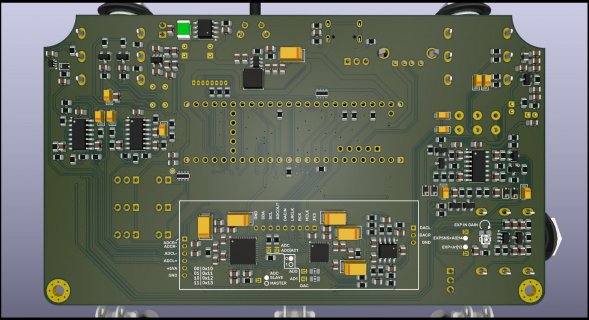

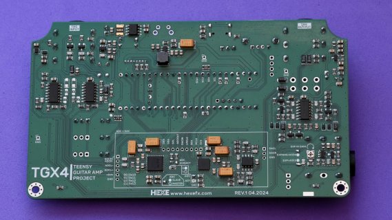

Progress update:
populated two boards, one used as testing bed for each circuit block and the other as "final". No major hiccups so far, added only a few changes, nothing requiring board reorder (which was not cheap - 4 layers over 100mm). Also found a bug in KiCad component library in the process.
The analog power supply for the ADC/DAC is 5V, initially i thought the input gain x2 will be fine, but after testing it with different guitars the signal was clipped with a hard pluck on stronger humbuckers. The input gain is now set to 1.
Next step: write drivers for the AK4452 + AK5552 and get the I2S going.
Got the AK5552+AK4452 working with 32bit/44.1kHz. The difference is huge. Practically zero oscillation and much lower noise. Here is a visual comparison of the hi gain preset 5 output, inputs are shorted to GND:
