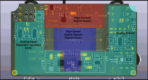

Looking at the space allocation on the board, I have naive noise related questions to ask:
it seems the 9v power is very close to an output jack, similarly the T41 board is in the middle of the board, why not prefering a digital+power signals split from the audio signals (e.g. could the I/O jacks better on the other side closer from ADC/DAC sub-circuit layout) ?
I know you have great gnd planes as it is a 4-layer board, but I'm an audio circuit noob and I'm trying to learn something here so pardon my basic questions!
1590XX is a larger box compared to a typical stompbox sizes. For that reason i wanted to have the jacks on the top and leave the sides for any other connectors which might be added later (ie. MIDI).
9V input is not the noisiest point on the pcb. That would be the high (relatively speaking) current 5VDC switching regulator powering the Teensy and the display plus all the digital busses. With the Teensy's pinout, which can't be changed i've settled on this partitioning scheme:
The I2S signals have their series termination resistors to roll off the sharp edges and minimize crosstalk.

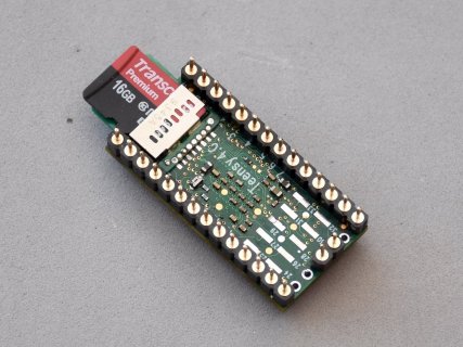

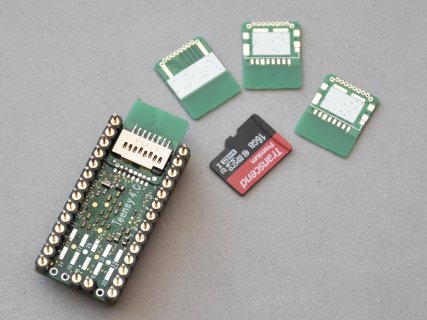

The SD card expansion boards for the Teensy4.0 arrived. I think i missed some kind of discount, because the price for the flex boards suddenly jumped 3x up. In the end i went with a 0.6mm dual layer pcb. Installing it is a bit finicky, but all went good, SD card is detected and works.
Why no castellated holes? The minimum diameter at JLC is 0.5mm, with that the annular ring would be too small giving the minimum clearance. I've used 0.4mm plated holes. A bit of flux + larger soldering tip made the solder flow and connect with the pads underneath. If it didn't work, i could always cut the edge of the board with a diamond disc cutter and make the castellations myself. Luckily it wasn't necessary.

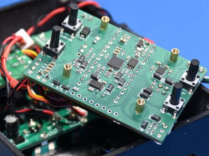

Teensy 4.0 Cabsim project update.
Hardware tested successfully. I had to bodge in a few changes, the final pcb will have all of them updated.
Main PCB:
In the final version i made both, the Teensy and the display pads offset, so they can be plugged in while testing and troubleshooting the hardware.

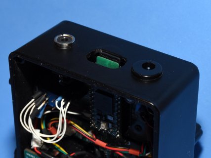

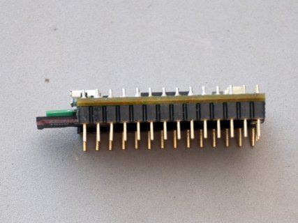

SD card:
I was afraid it will be protruding out of the enclosure too much, risking ripping the pads on the Teensy off. Turned out to be quite ok, about 1mm only, enough to grab it and pull it out without any tool.

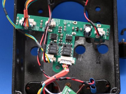

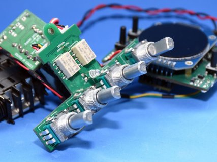

Pots + Bypass module:
The connectors should be vertical, but the seller sent them all wrong. Didn't want to wait for the new ones, horizontal works, too.
This is an independent module with 4 pots and a stereo true bypass made with two latching relays. The controller (footsw. debounce, driving the single coil relays) is a cheap Padauk PFS154, realys are driven with also cheap 8pin H-bridge chip/motor controller. A pink led completes the system.

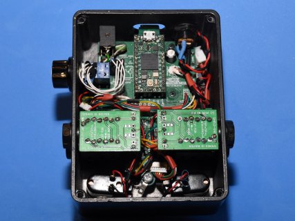

With all these boards, lots of wiring and space constrains putting it all together was a real 3d puzzle.
I'm using a stacked 2x TRS jacks for in and out configured for various plug types:
Input: mono 1x TS, Stereo 2x TS or a single TRS
Output: Single TRS or two TS
The side potentiometer is for Headphone volume (optional). Headphone amp: PAM8908. Really like this chip. It has an internal charge pump to create bipolar supply. No need for huge DC blocking capacitors, plus the output is GND referenced, can be used as 2nd line out.
