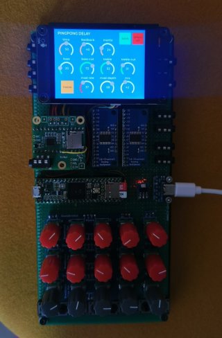

yes undertsood. I tried with the StereoDelay and it works super ! I guess this is not an option for the stereoPlateReverb..? well I tried and it gave an error. No matter. I will also try with the SC reverb but am sure it will work. Originally I was trying to figure out how to use the regular delay in the standard Teensy Audio library to make use of the psram for audio blocks instead of AudioMemoty() in RAM. But after a lot of reading I gave up. In anycase I really love your amaxzing fX, so its not a problem. Here is my test 'rig' : an esp32s3 2.8" touch screen with lvgl GUI (still in development) controlling a Teensy4.1. Quad audio (just 2x audio shields currently) and a bunch of knobs and switches with mux's to scan them to control both synth engine and some fx parameters.

Loving the layout
