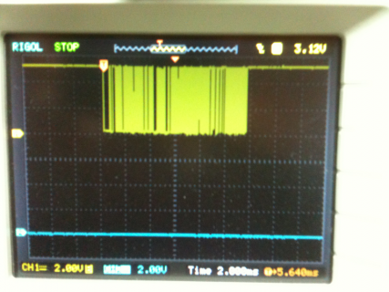

And now to the problem:
In the old version all works fine just, but in new one it seems there is an issue with this functions if some of this is called
#define DIRECT_READ(base, mask) (*((base)+512))
#define DIRECT_MODE_INPUT(base, mask) (*((base)+640) = 0)
#define DIRECT_MODE_OUTPUT(base, mask) (*((base)+640) = 1)
#define DIRECT_WRITE_LOW(base, mask) (*((base)+256) = 1)
#define DIRECT_WRITE_HIGH(base, mask) (*((base)+128) = 1)
My T3 get broken and the T3 stopped working. I don't think it's on the functions above I reckon it's more a Problem how they called inside the wrapped interrupt function, but I have no answer.
I don't know why it don't work in this way, can someone help me please.

Changing this to this helps I don't know why:
//volatile IO_REG_TYPE *reg IO_REG_ASM = baseReg;
volatile IO_REG_TYPE *reg IO_REG_ASM = PIN_TO_BASEREG(_pin);
And making this works quit fine
uint8_t _pin;
OneWireSlave::OneWireSlave(uint8_t pin) {
	_pin = pin;
	pinMode(_pin, INPUT);
	pin_bitmask = PIN_TO_BITMASK(_pin);
	baseReg = PIN_TO_BASEREG(_pin);
	#define dsslavepin _pin
        attachInterrupt(dsslaveassignedint, &ISRPIN, CHANGE);
volatile uint8_t errno = 0;                //neccessery to bring errno direct in.
but this brings it down:

Seems to work pretty well. This may be useful for my TeensyPi project, as I am interested in placing other devices (thermocouples, humidity sensors, etc) on the 1-wire bus. Nice Job.
Update:
I may have spoken too soon...
I've got two Unos, one running as a 1-wire master and one as a 1-wire slave, running on a very short (< 10") 1-wire mini-lan. It works for a while, then the slave appears to give up the ghost. Since I don't have a scope or logic analyzer available it's kind of hard to see what's dying...
Oh well...

Oh sorry to hear that I worked on some strange behaviors I post my latest files. ATM I worked with 2 Teensy 3.0 to test it and there I had tests for several hours working fine.
My latest files there.
There are some issues I working on, I think the Uno is fast enough, I can't remember that an Slave disappear in the latest ones can you test it with this files again and show my your sketch so I know that you do.

Changed the slave to a Teensy 3.0, and now the slave is responding just fine, apparently the Uno just doesn't have enough "oomph"...
"oomph" sounds nice, there is somewhere an problem with the timing, I don't know why, think it's time to get an scope...
And yes the Teensy 3.0 works really fine.

I used your DS18B20_Slave_Interrupt_T3 example using a Teensy3.0 as a base. I'm using pin 9 as the dsslavepin.
With the 1.0.6/1.20 IDE, the code compiles and communicates just fine.
With the 1.6.3/1.22 IDE the code compiles, but seems to get stuck sending a stream of presence pulses.
Need a scope. Did the other example also didn't work?
Lookd like DS18B20_Slave_Interrupt_universal_analogread works atm don't know why the other not
