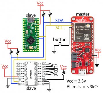

I'm prototyping a MIDI controller with an ESP32 board as the main MCU, but also using a Teensy LC for its easy usbMIDI capabilities. And there's an MCP23017 i2c i/o expander that's used to control a bank of LEDs.
These 3 components talk to each other over an i2c bus, with the ESP32 board (SparkFun Thing Plus) acting as master, and the Teensy LC and MCP23017 in slave mode. The Teensy LC and MCP23017 are assigned different i2c addresses (0x33 and 0x20 respectively), and there are 3k pullup resistors to Vcc (3.3v) on each i2c line near each slave device.
For current communication-testing purposes:
These 2 things each work perfectly one at a time. But when I try them at the same time, they both stop working. With both communication tasks going, the LEDs blink correctly, and everything works when I push the MIDI test button once. But when I press it a second time, the LEDs stop blinking, and no further usbMIDI messages are sent.
Code running on the esp32 and teensyLC, respectively:
If I look at the log printed to Serial from the Teensy in this failure case, it appears to be incorrectly "receiving" the same 5-byte message over and over again, and the extra incorrect messages correspond temporally to each time the LEDs are supposed to blink (once per second). But with 2 extra null bytes appended each time. (It should be noted that the i2c messages to the MCP23017 are exactly 2 bytes long... hmm) So it seems like some wires are getting crossed somewhere, such that either the message is being incorrectly concatenated and retransmitted, or not being cleared from some queue on the receiving end. But I'm not sure of how to further debug.
Here's a log from when the MIDI button is working correctly, without the LED communication going. All looks good. (170 == 0xAA which is the magic start byte, the rest correspond to the MIDI values I'm sending as a test):
And here's a log from the failure mode when it crashes with the MCP23017:
Thanks for reading. Any hints or suggestions are appreciated!
- once every second, the esp32 master sends commands via i2c to the MCP23017 to blink the LEDs to count in binary. (simplest way to test because it uses a register based control scheme)
- the esp32 master waits for a button press, and when it detects one, sends data via i2c to the Teensy LC representing a MIDI note on/note off. Each keypress is sent as a 5 byte message starting with a magic number byte (0xAA). The Teensy interprets and forwards these messages via usbMIDI.

read byte value: 35
read byte value: 3
read byte value: 60
read byte value: 0
read byte value: 0
read byte value: 0
read byte value: 0
read byte value: 0
read byte value: 0
read byte value: 0
read byte value: 0
read byte value: 0
read byte value: 0
read byte value: 0
read byte value: 0
read byte value: 0
read byte value: 0
read byte value: 0
Received 19 bytes over i2c
onReceive handler called with 21 bytes
read byte value: 170
read byte value: 35
read byte value: 3
read byte value: 60
read byte value: 0
read byte value: 0
read byte value: 0
read byte value: 0
read byte value: 0
read byte value: 0
read byte value: 0
read byte value: 0
read byte value: 0
read byte value: 0
read byte value: 0
read byte value: 0
read byte value: 0
read byte value: 0
read byte value: 0
read byte value: 0
read byte value: 0
Received 21 bytes over i2c
onReceive handler called with 23 bytes
read byte value: 35
read byte value: 3
read byte value: 60
read byte value: 0
read byte value: 0
read byte value: 0
read byte value: 0
read byte value: 0
read byte value: 0
read byte value: 0
read byte value: 0
read byte value: 0
read byte value: 0
read byte value: 0
read byte value: 0
read byte value: 0
read byte value: 0
read byte value: 0
read byte value: 0
read byte value: 0
read byte value: 0
read byte value: 0
Received 23 bytes over i2c
onReceive handler called with 25 bytes
read byte value: 35
read byte value: 3
read byte value: 60
read byte value: 0
read byte value: 0
read byte value: 0
read byte value: 0
read byte value: 0
read byte value: 0
read byte value: 0
read byte value: 0
read byte value: 0
read byte value: 0
read byte value: 0
read byte value: 0
read byte value: 0
read byte value: 0
read byte value: 0
read byte value: 0
read byte value: 0
read byte value: 0
read byte value: 0
read byte value: 0
read byte value: 0
Received 25 bytes over i2c
onReceive handler called with 27 bytes
read byte value: 35
read byte value: 3
read byte value: 60
read byte value: 0
read byte value: 0
read byte value: 0
read byte value: 0
read byte value: 0
read byte value: 0
read byte value: 0
read byte value: 0
read byte value: 0
read byte value: 0
read byte value: 0
read byte value: 0
read byte value: 0
read byte value: 0
read byte value: 0
read byte value: 0
read byte value: 0
read byte value: 0
read byte value: 0
read byte value: 0
read byte value: 0
read byte value: 0
read byte value: 0
Received 27 bytes over i2c
onReceive handler called with 29 bytes
read byte value: 35
read byte value: 3
read byte value: 60
read byte value: 0
read byte value: 0
read byte value: 0
read byte value: 0
read byte value: 0
read byte value: 0
read byte value: 0
read byte value: 0
read byte value: 0
read byte value: 0
read byte value: 0
read byte value: 0
read byte value: 0
read byte value: 0
read byte value: 0
read byte value: 0
read byte value: 0
read byte value: 0
read byte value: 0
read byte value: 0
read byte value: 0
read byte value: 0
read byte value: 0
read byte value: 0
read byte value: 0
Received 29 bytes over i2c
onReceive handler called with 31 bytes
read byte value: 35
read byte value: 3
read byte value: 60
read byte value: 0
read byte value: 0
read byte value: 0
read byte value: 0
read byte value: 0
read byte value: 0
read byte value: 0
read byte value: 0
read byte value: 0
read byte value: 0
read byte value: 0
read byte value: 0
read byte value: 0
read byte value: 0
read byte value: 0
read byte value: 0
read byte value: 0
read byte value: 0
read byte value: 0
read byte value: 0
read byte value: 0
read byte value: 0
read byte value: 0
read byte value: 0
read byte value: 0
read byte value: 0
read byte value: 0
Received 31 bytes over i2c
onReceive handler called with 32 bytes
read byte value: 35
read byte value: 3
read byte value: 60
read byte value: 0
read byte value: 0
read byte value: 0
read byte value: 0
read byte value: 0
read byte value: 0
read byte value: 0
read byte value: 0
read byte value: 0
read byte value: 0
read byte value: 0
read byte value: 0
read byte value: 0
read byte value: 0
read byte value: 0
read byte value: 0
read byte value: 0
read byte value: 0
read byte value: 0
read byte value: 0
read byte value: 0
read byte value: 0
read byte value: 0
read byte value: 0
read byte value: 0
read byte value: 0
read byte value: 0
read byte value: 0
Received 32 bytes over i2c
