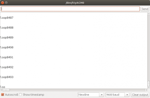

loop386
[B]The extreme aversion to dynamic memory allocation stems
long text printed bytes ==56
[/B] bigAssString = :: length()=1437
0,1,2,3,4,5,6,7,8,9,10,11,12,13,14,15,16,17,18,19
20,21,22,23,24,25,26,27,28,29,30,31,32,33,34,35,36,37,38,39
360,361,362,363,364,365,366,367,368,369,370,371,372,373,374,375,376,377,378,379
380,381,382,383,384,385,386,
[B] bAS print size==1440
RAM freeMemory() == 219
[/B]loop387
[B]long text printed bytes ==0
[/B] bigAssString = :: length()=1441
40,41,42,43,44,45,46,47,48,49,50,51,52,53,54,55,56,57,58,59
60,61,62,63,64,65,66,67,68,69,70,71,72,73,74,75,76,77,78,79
80,81,82,83,84,85,86,87,88,89,90,91,92,93,94,95,96,97,98,99
100,101,102,103,104,105,106,107,108,109,110,111,112,113,114,115,116,117,118,119
120,121,122,123,124,125,126,127,128,129,130,131,132,133,134,135,136,137,138,139
140,141,142,143,144,145,146,147,148,149,150,151,152,153,154,155,156,157,158,159
160,161,162,163,164,165,166,167,168,169,170,171,172,173,174,175,176,177,178,179
180,181,182,183,184,185,186,187,188,189,190,191,192,193,194,195,196,197,198,199
200,201,202,203,204,205,206,207,208,209,210,211,212,213,214,215,216,217,218,219
220,221,222,223,224,225,226,227,228,229,230,231,232,233,234,235,236,237,238,239
240,241,242,243,244,245,246,247,248,249,250,251,252,253,254,255,256,257,258,259
260,261,262,263,264,265,266,267,268,269,270,271,272,273,274,275,276,277,278,279
280,281,282,283,284,285,286,287,288,289,290,291,292,293,294,295,296,297,298,299
300,301,302,303,304,305,306,307,308,309,310,311,312,313,314,315,316,317,318,319
320,321,322,323,324,325,326,327,328,329,330,331,332,333,334,335,336,337,338,339
340,341,342,343,344,345,346,347,348,349,350,351,352,353,354,355,356,357,358,359
380,381,382,383,384,385,386,387,
[B]bAS print size==1444
RAM freeMemory() == 215
[/B]
loop401
long text printed bytes ==1
bigAssString = :: length()=1494
380,381,382,383,384,385,386,387,388,389,390,391,392,393,394,395,396,397,398,399
400,,
[B] bAS print size==1497
RAM freeMemory() == 162
[/B]
[B]loop2790[/B]
bigAssString = :: length()=1495
400,,
[/B]
