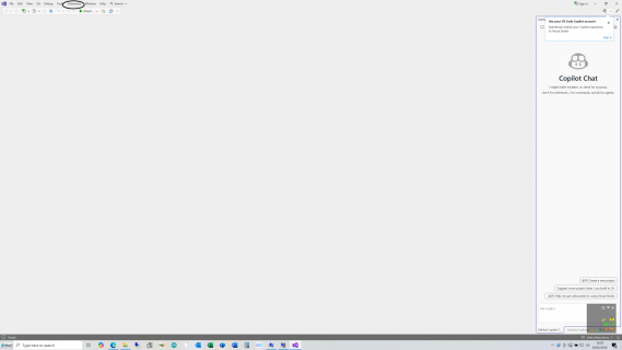

You will now be presented with the following screen…
Not a very helpful screen!
Select Extensions, then Manage Extensions.
Select to install Arduino IDE for Visual Studio 2022+
