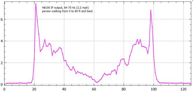

You can buy a HB100 doppler radar module for well under $5 at the usual auction sites. This sort of thing is used for automatic door openers with short range, say 10 feet. The HB100 has a mV-level baseband IF output, which I boost with a x660 opamp circuit (OPA209A) and 0.1 uF cap directly into the Teensy 3.2 pin 16 (A2). The output is a frequency proportional to target speed: Frequency (Hz) / 31.37 = Speed (mph). I use the audio library's FFT1024 object to select out just my walking speed which is 2.2 mph, which means a signal near f=70 Hz. That, plus a crude aluminum-foil-and-cardstock horn for directivity, allows a pedestrian-detection range of 80 feet, which is a considerable improvement over the "stock" sensor (esp. given radar signals drop as 1/r^4). Many thanks to Frank B for the code to cut the ADC sample rate x4 for smaller frequency bins, and neutronned for the example code I modified.
The plot below shows the 2.2 mph frequency channel as I walk directly away from the sensor out to 80 feet, then immediately return the same way.
