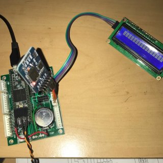

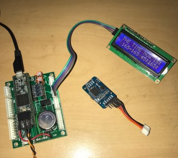

Since I did not have a 4 line LCD , just modified the code for a 2 line LCD and is given below. The problem as I notice :
When both the LCD and RTC are plugged in ,
A. applying power 10 times , results in the program starting up 4-5 times . Rest of the time the LCD does not initialize..
B. Pressing Reset at any time freezes the code ( even if the clock is showing the time )
When the RTC is pulled out , the LCD works, and the Reset works as they should.
And another point ... not sure if it means anything .. the start up is more reliable when powering from the T3.5 from a battery instead of the PC USB port
I purchased the 4 line LCD because you said that was the display you were using.
Sorry about that. But OK... it also goes to confirm that the problem is across the spectrum of 2 Line or 4 line LCDs.
And since all of them use the HD44870 chipset, the code that I sent will work as is - except that the last 4 columns , and two bottom rows will be blank. And since we are checking the functionality per se, this should not be an issue.
But going past all these ( which are kind of manageable with the built in RTC which is what I am doing now ) what concerns me is the board freezing on a hardware reset. When all else fails that is the last resort on all MCUs and in this case that freezes a working code. ????
Seeking clarification: in post #19 you said "When the RTC is pulled out , the LCD works, and the Reset works as they should.". But now are you saying even without the DS3231, the board freezes on a hardware reset?
By "hardware reset", do you just mean pushing the button on the T3.5? that button just does a re-program.
curiously, your 2nd photo in post #19 has the same bogus time I was getting in my tests in post #18 when the DS3231 hung. From the arduino.cc URL in #18, it is evident the DS3231 has issues holding the I2C lines. The i2c_t3 lib Wire.resetBus() seems to fix hangs on the DS3231, but that may no longer matter if you are no longer using the DS3231.
- Yes. Even without the RTC plugged in, the code freezes on hardware Reset.
- Yes. The one on the board is NOT the Reset button. Its for Program download.
- Bogus time. Yes again because the RTC is lying on the table unconnected.
Aren't i2c devices among those tend to power up slower than the Teensy? And warm start versus power on shows that up - maybe why the battery power version acts better.
Perhaps make setup() start like this with added delay()?
  // START SERIAL FOR DEBUGGING
[B]  delay(1000); // Less delay may work - if this is the issue it should be time in excess ...[/B]
