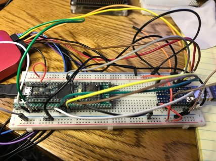

A few of us (@mjs513, @defragster, and myself) have been working to add Bluetooth support the library
Currently in the Fork/Branch: https://github.com/KurtE/USBHost_t36/tree/WIP2-Bluetooth
Hopefully soon we will merge some of the WIP code into the main code, that gets installed when you install Teensyduino.
We are making some good progress and have some device working, including some keyboards, some Mice and some Joysticks.

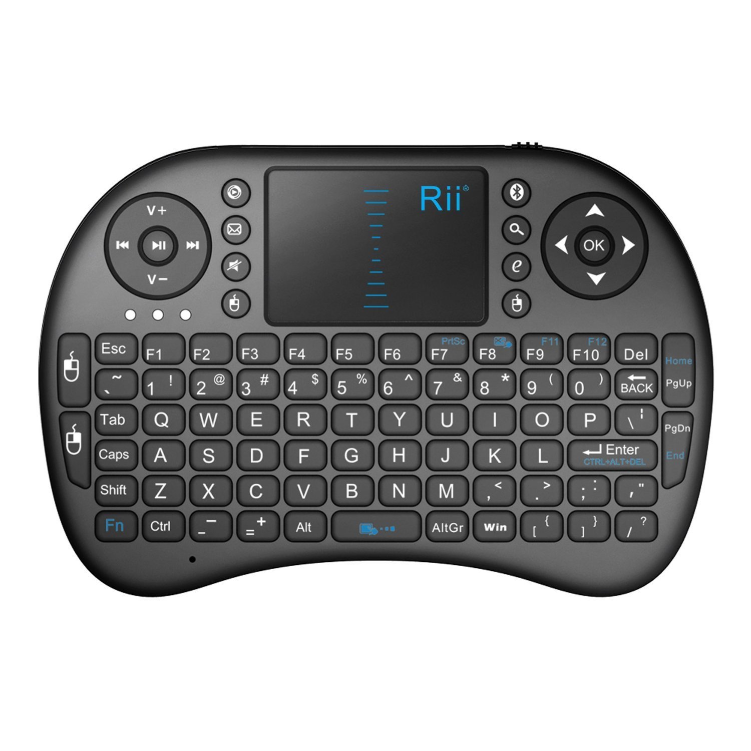

Need to Edit: above table, but so far I have had working some of the hardware:
Mouse:
Tecknet …
MSFT Sculpt Mouse (m#1497)
Logitech Mouse M557
Keyboard:
rii, and Rii i8+
logitech K400+, K480 Triple Select
MSFT Mobile 6000
Joysticks
PS3 (including a clone or two) **
PS4
** For PS3 controller it must be USB paired in advance - plug in cable to PS3 - then Bt Dongle to see non-zero BDADDR:
To initiate Bt pair - while on USB:: Hold select button and press PS button to set controller associate.
