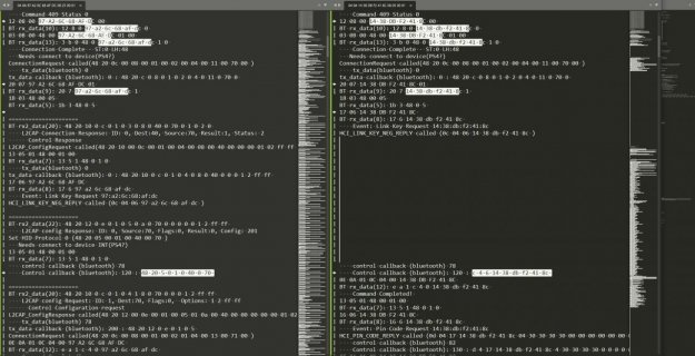

Took break to play with PS4 again since I received the new PS4 clone.
Seems to hang the USBHost_t36 and I have to hit the pgm button to upload the sketch again:
dies here.
With the USBHost shield says its paired but the blue light on the PS4 doesn't stay on (keeps blinking) and no data:
stops at send connection request.
PS4 Bluetooth Library Started
Bluetooth Dongle Initialized
HCI Reset complete
Write class of device
Local Bluetooth Address: 00:19:86:00:0E:E0
Please enable discovery of your device
Gamepad found
HID device found
Now just create the instance like so:
BTHID bthid(&Btd);
And then press any button on the device
Remote Name: Wireless Controller
PS4/PS5 controller is connecting
Connecting to HID device
Connected to HID device
Received Key Request
Bluetooth pin is set too: 0000
Pairing successful with HID device
Send HID Control Connection Request
