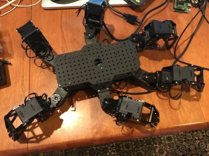

Then I may get distracted some with the second package that arrived today:

Our messages crossed. Very cool spider -- will have to do that one of these days - think that will be a good project for the T4.

Oh, forgot where did you get the spider
