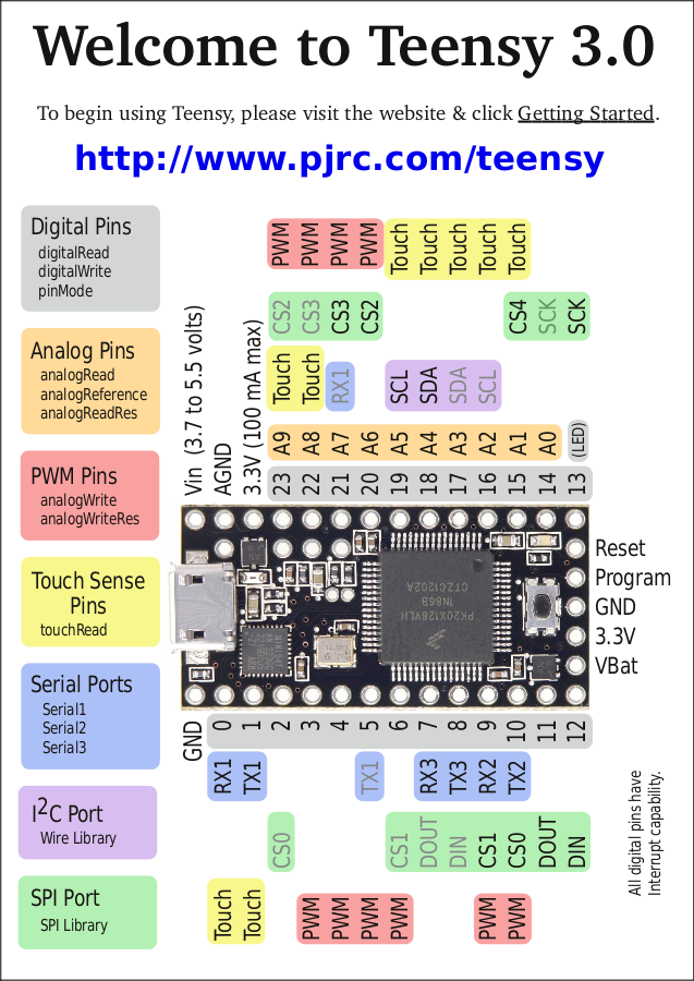

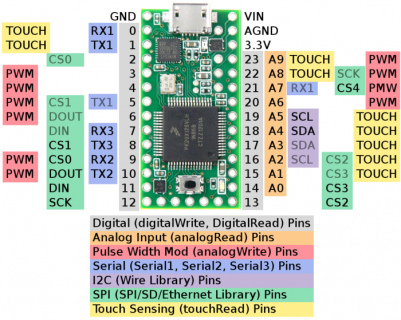

I noticed there seemed to be 4 SPI outputs on the T3. Can these be used at the same time (i.e. one clock, three data) or is this really a single SPI output? The FEZ Panda II has 2 SPI ports which allows 2 runs of LEDs that do not have chip select / disable capabilities. If there were a way to stream 4 sets of such LEDs at once, that would be an amazing capability. I am not asking for a library to do this, just to know the raw SPI system could or could not handle such a task.
