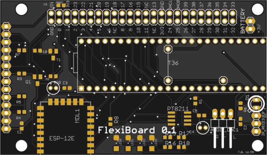

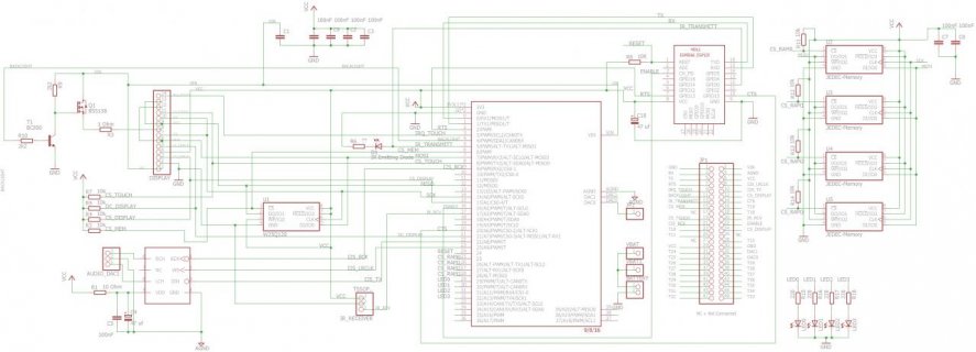

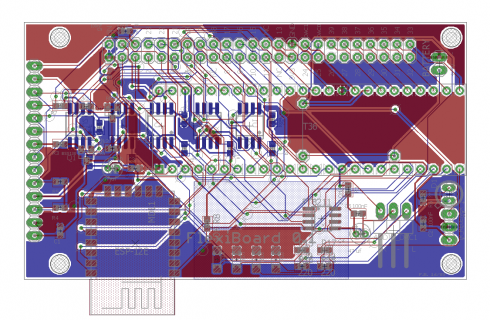

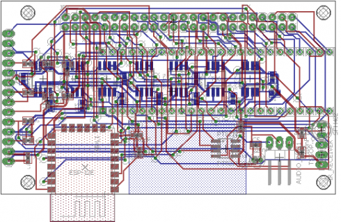

I'd like to make a new Board. It would be great if you can check the schematic if there are any problems

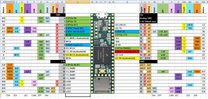

It will be soldered to the ILi9341 Touch-Display and I tried to choose the pins in a way that all components are optional and it works with all Teensy 3.x (T3.0 .. T3.1 without Esp8266)
- PWM for Display-Backlight
- WLAN with ESP8266 (Board ESP12e), Hardware-Handshake with RTS and CTS possible, Flashing the ESP is possible, i hope EDIT: IS possible)
- Audio either DAC0/DAC1, PT8211, or Audioshield (without PIN 15, volume-pot)
- if no Audioshield, there are Pads to solder a W25Q128 Flash
- connector for IR-Recieve (for example TSOP xyz Chips, or Sharp, or...)
- connector for IR-Transmit

Attention: SPI0 is not connected to the big pinheader!
All is optional, even the display..
All hints welcome

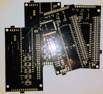

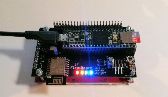

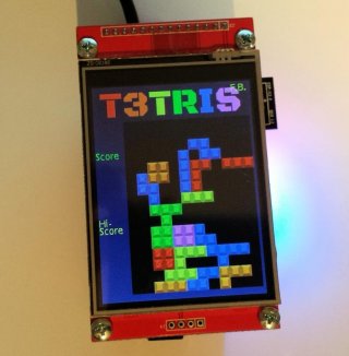

Edit: some pics:

Edit: some pics:
