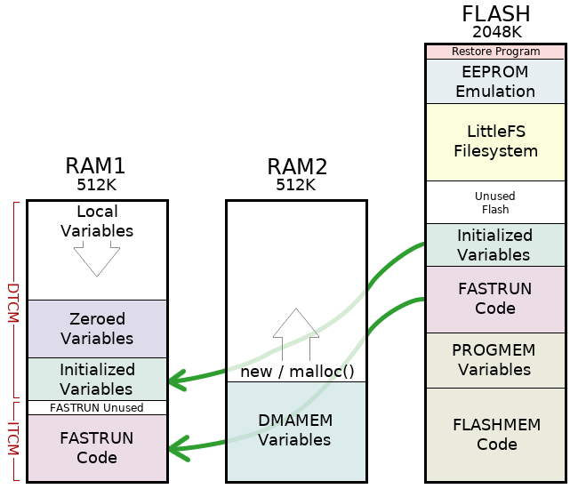

T4.0 Memory - trying to make sense of the different regions
EDIT: quick recap from msg #24: working to solve these 3 issues:
1: Clear & easy to understand documentation is needed
2: Arduino's size info doesn't fit the memory model
3: PROGMEM can't be used for both code & data in the same file
I've added a "Memory Layout" section to the Teensy 4.0 product page.
I tried to explain it from the programming point of view, with some notes near the end about the hardware considerations. I mentioned the DMA issues briefly, but I'm feeling like DMA usage wants to be another page (and those words will become a link to it).
I shied away from discussing the low-level details of FlexRAM config, other than mentioning 32K round up and small unused space. Hopefully emphasizing how you actually use the memory from code, and de-emphasizing the hardware config, will help the most people?
Please let me know what you think?

Thanks, Paul, that's super useful and clear.
A couple of thoughts:
Would it be possible to add the default values for the various fixed addresses?
One note on the graphic: I puzzled over why there was an arrow from DMAMEM to FASTRUN code for a couple of seconds, then I realized that the arrow goes under the RAM2 block. Maybe rearrange the columns in the diagram to go from left to right: Flash, RAM1, RAM2 with the arrows going from left to right...
Would it also be possible to put in a few lines of example code showing how to mark items to be loaded into the appropriate sections?

I did a quick scan of the 'Memory Layout' - looks very good. @KurtE - would be good to add to OP if not already done.
@KurtE - as I understand and from the startup memcopy it seems Any code not PROGMEM gets brought into the RAM1 area on startup.

I agree the pictorial representation isn't clear with those vanishing arrow lines. Perhaps put the FLASH memory SPACE in the MIDDLE and the RAM1 on the LEFT with arrow to where it resides and them the RAM2 on the right showing it is detacahed from FLASH startup and it RunTime RAM?
Also yes - having the picture show the "default values for the various fixed addresses" for the key areas would be helpful. Also is there a way at runtime to know where the 'Unused Flash' area starts? Startup could make a 'global' pointer to the space after 'Initialized Variables'
How about this? Does it help?
That'll take much more work since it's drawn with the Gimp using many layers. :(
That is a good (enough) improvement having the lines not vanish into and pop out of RAM2.
