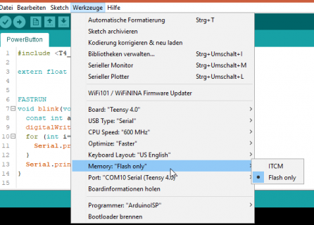

set model=teensy40
set speed=600
set opt=o2std
set usb=serial
As KurtE noted it might take an extra setting to pass a menu option for that - unless it was part of "set opt" and I didn't look close enough.
LOL... as you want...
No need to edit platform.txt.
@Tim: set memory=
should do it.
.. Have fun til next update :)
