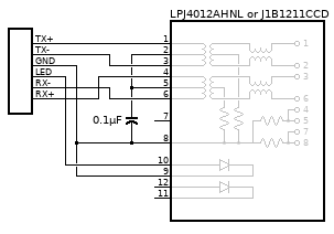

First up, great new board the 4.1
I know your going to get a lot of this sort of thing.
The Ethernet board, if the 6 pins on the Ethernet board were off set to one side, then it looks like the Ethernet board could be soldered via pins direct to the 4.1, no need for cable, unless you wanted one,
Removes worry about the EM problems with the cable, let alone the cost of cable and connectors,
now if the Ethernet card was wide enough that there were side pins that soldered down to the side pins on the 4.1 as well, may be 4 of them, then a strong enough for testing unit would be able to be made,
