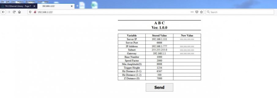

Teensy 4.1: Webserver crashes on submit (using NativeEthernet library)
I have a webserver sketch that worked fine on a Teensy 4.0, however, it is crashing on the Teensy 4.1 using the latest NativeEthernet library.
The webserver (code attached) displays a Table and a Submit button. The Table reads and displays variables stored on the micro. That part works fine as before with any browser.
The part that does not work is when I press the submit button on the page. The request received by the Teensy 4.1 is never completed and the server crashes well before it reaches the rest of my code.
I would appreciate the community's help is to what may be causing that?
Thanks in advance.
