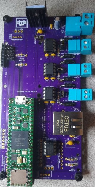

T4.1 Ethernet file server
Hy,
I'm currently making an CANbus logger that is attached to ethernet. The goal is to log the canmessages to the SD card and be able to download the logfile from the teensy over ethernet.
However i'm having some troubles with the download of the files. i'm able to get the root folder displayed and download files from it. However, at around the 6-10th refresh of the page, i suddenly get a file = 0 and am not able to display the page, even tho the request is the same. After that, it keeps giving me the File Not Found Error.-
Seriallog:

partial arduino code:
void ethernet_client(){
    // listen for incoming clients
    if(!client) client = server.available();
    if (client){
      #ifdef DEBUG
      Serial.println("new client");
      // reset the input buffer
        char clientline[BUFSIZ];
        int index = 0;
      noInterrupts();
      while (client.connected()) {
        if (client.available()) {
          char c = client.read();
          // If it isn't a new line, add the character to the buffer
          if (c != '\n' && c != '\r') {
            clientline[index] = c;
            index++;
            // are we too big for the buffer? start tossing out data
            if (index >= BUFSIZ)
              index = BUFSIZ -1;
            // continue to read more data!
            continue;
          // got a \n or \r new line, which means the string is done
          clientline[index] = 0;
          #ifdef DEBUG
          // Print it out for debugging
          Serial.println(clientline);
          // Look for substring such as a request to get the file
          if (strstr(clientline, "GET /") != 0) {
            // this time no space after the /, so a sub-file!
            char *filename;
            filename = clientline + 5; // look after the "GET /" (5 chars)  *******
            // a little trick, look for the " HTTP/1.1" string and
            // turn the first character of the substring into a 0 to clear it out.
            (strstr(clientline, " HTTP"))[0] = 0;
            if(filename[strlen(filename)-1] == '/') {  // Trim a directory filename
              filename[strlen(filename)-1] = 0;        //  as Open throws error with trailing /
            #ifdef DEBUG
            Serial.print(F("Web request for: ")); Serial.println(filename);  // print the file we want
            if(true) // file request
              #ifdef DEBUG
              Serial.println("Main site");
              File file = SD.open(filename, O_READ);
              if ( file == 0 ) {  // Opening the file with return code of 0 is an error in SDFile.open
                client.println("HTTP/1.1 404 Not Found");
                client.println("Content-Type: text/html");
                client.println();
                client.println("<h2>File Not Found!</h2>");
                client.println("<br><h3>Couldn't open the File!</h3>");
              #ifdef DEBUG
              Serial.println("File Opened!");
              client.println("HTTP/1.1 200 OK");
              if (file.isDirectory()) {
                Serial.println("is a directory");
                client.println("Connection: close");  // the connection will be closed after completion of the response
                client.println();
                client.println("<!DOCTYPE HTML>");
                client.println("<html>");
                client.println();
                client.print("<h2>Files in /");
                client.print(filename);
                client.println(":</h2>");
                //File entry = file.openNextFile(); // clear the SYSTEM~1/ folder
                while (true) { // write out all the files and end while
                  // done if past last used entry
                  if (! entry) {
                    // no more files
                  // print any indent spaces
                  client.print("<li><a href=\"");
                  client.print(entry.name());
                  if (entry.isDirectory()) {
                    client.println("/");
                  client.print("\">");
                  // print file name with possible blank fill
                  client.print("</a>");
                  client.println("</li>");
                  entry.close();
                client.println();
                client.println("</html>");
                file.close();
              else { // Any non-directory clicked, server will send file to client for download
                client.println("Content-Type: application/octet-stream");
                client.println();
                char file_buffer[ETH_BUFFER_SIZE];
                int avail;
                while (avail = file.available())  {
                  int to_read = min(avail, ETH_BUFFER_SIZE);
                  if (to_read != file.read(file_buffer, to_read)) {
                  client.write(file_buffer, to_read);
                file.close();
          else { // everything else is a 404
            client.println();
            client.println("<h2>Error 404: Page not found!</h2>");
      interrupts();
      // give the web browser time to receive the data
      delay(1);
      // close the connection:
      client.stop();
      #ifdef DEBUG
      Serial.println("client disconnected");
full code: View attachment canDBC.ino

Teensy Eithernet
Thanks for the great work.
I have never work with Ethernet with a micro before so I am just fumbling around.
I developed a CAN BOB for the 4.1 which included Ethernet.
I tried the Link example but it says there was no connection even though the cable was connected.
But when I ran the DhcpAddressPrinter.ino and connected to a router I was served and IP and it was printed out. After that...nothing happened. No more messages. I this correct?
I added an IP recheck at the below the case statement and no issue just kept printing out the same IP so I am assuming the PCB design is correct? Green light is blinking so I am assuming there is data going back and forth?
Just trying to figure out an easy way to make sure my PCB design is correct.
Thanks
Bruce
