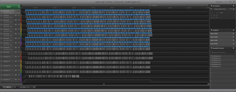

This one shows the issue that with 2 Shifters 0 and 1, when 0 finishes 1 does not output anymore...
Probably all for now. May do some other diversion

Know this is going to sound strange but could you put you LA on it again using these prints:
  SerialFlex.print ("Flex112345");
  SerialFlex2.print("Flex2 More");
  SerialFlex.print (" second Flex output1");
  SerialFlex2.print(" Flex 2 output again");
@KurtE
Yep - But all of this is strange....

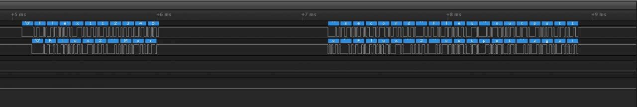

So you are going to say it looks like maybe it output the last stuff? BUT again the odd part...
In each case it looks like the last character is output (as shown in RED, but in both cases the character is not shifted out. In the first set of outputs, it does get shifted out when the first byte is output of the next sequence...
Yeah, that's kind of what I wanted to check. It is strange. Its almost like you have to flush the last character or send a 0xff or 0x00 just to complete the sequence - think I saw that someplace but I cant remember what it was referring too.

@KurtE
Confused is the normal state for me :) Guess I will have to go back to the manual and bounce the two off each other. Either that or I can run the SDK interrupt example on the 1062EVKB and try to duplicate what is being done in the sketch to see what happens :) Waiting for wife at Dr's now so may be awhile....
@KurtE
I loaded up the interrupt SDK example on the 1062EVKB and saw a couple of things. First, the way the sdk is set up is it transmits on one pin and recieives on another. So I hooked up the USB converter to the pc and opened the serial monitor. Sent it a input string of "12345678":
12345  (CR/NL) 1st send 12345678
678    (CR/NL) 2nd send 12345678
123
45678  (NL)  3rd send 12345678
1
Do a reset and select no line ending
12345678
not sure it means anything for us or just a quirk with the SDK.
But played some more with padding the shorter prints with spacers instead of number, i.e.,
  SerialFlex.printf("Flex1     ");
  SerialFlex2.printf("Flex2 More");
  SerialFlex.print(" second Flex output     ");
and I think it worked this time>>>>> heres the output:

Don't know just throwing things out there and seeing if something clicks..... Now to read the manual.
@mjs513 (and others) - I may have fixed my multiple FlexSerial transmit issue...
I believe: The TIMCTL register did not have the right TRGSEL value (I think).
I think it needs to 4* Shifter number + 1 (was hard coded to 1) so was specific to shifter 0...
The documentation for this at times is a bit confusing.

Sorry to be bumping this old thread, but Kurt - you're my best option right now to point out if anything is missing and it's relevant to the content of this thread.
After I successfully got FlexIO to wring 8 bit parallel data on a single shifter/timer in a blocking method and driving an ILI9488, I now want to get all 8 shifters working and loading them with data via DMA.
The code attached has been referenced from two sources, NXP's RT1050 FlexIO lcd demo, and the KL28 FlexIO lcd demo.
It has been setup for a Teensy 4.0/4.1 using FlexIO pins 0-3. Pin 0 is routed to Timer0 output and pins 1-3 are to the shifters output
If I understand what is being done - a DMA channel has been set up to load 32 bytes of data into the 8 shifters as a minor loop iteration. It will go through so many major loops based on the length of the data/32.
Once it has gotten through all the minor loops (in my test code, just 1) it will complete the major loop and trigger the interrupt and completion.
For some reason, it's not triggering. I can only blame the DMA setup I have written, as I am not understanding some of the register settings or missing something crucial?
  • FlexIO_MultiBeat_DMA_demo.ino
