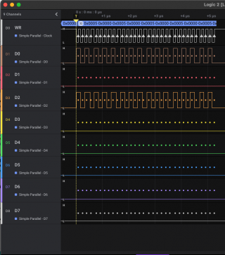

That actually works!! Although it's outputting 0x05, 0x00 16 times each and not 0x05 32 times
I commented out the dma.enable in the main loop to allow it to trigger just once, but here it is:
I'm not sure what might be causing that. When I run the code on a T4.0 the shift buffers appear to be loaded correctly with 0x05050505, which should be shifting out 0x05 one byte at a time... Does the same thing happen if you comment out the DMA setup and just copy 0x05050505 into the shift buffers to trigger FlexIO manually?

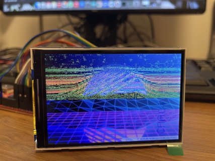

I went ahead and added the DMA code into my simple display driver and am seeing some odd behavior:
1. It's not completing all the major loop iterations - only half of them.
2. It's not pushing out the correct values to the bus
Here is a screenshot of the display running in standard polling mode using a single shifter:
Here it's running 1 second later with DMA:
I left all the DMA settings as is, but changes the source address to an uint16_t pointer that stores the address to the C image array with a size of 480x320 and 16 bit color per pixle
Here is what is printed out in the calculations before the DMA channel is configured:
destinationModulo: 4, MulBeatCountRemain: 0, MulBeatDataRemain: 1610772084, TotalSize: 153600, minorLoopBytes: 16, majorLoopCount: 9600
So to me it seems that it only completes roughly 4800 major loops, and it's not passing the full value per pixel.

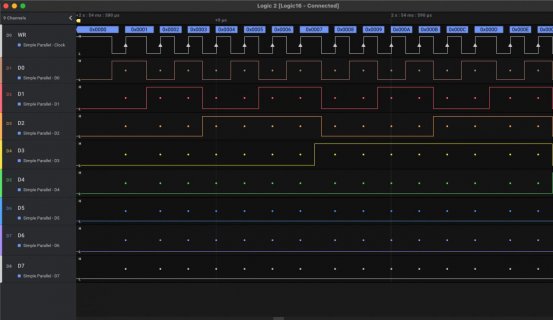

I hooked up the logic analyser to see what the first two bytes are when trying the DMA method
1. The first two bytes in the image are 0x40 and 0x0b as a 16 bit value 0x400b
2. The polling method outputs as expected, 0x40 and then 0x0b
3. The DMA method outputs 0x01 and then 0x08

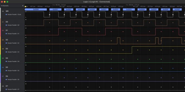

Almost, but still not quite there yet:
It sends out {0x01, 0x02, 0x03, 0x00, 0x01, 0x02, 0x03, 0x08,...}
Odd enough, ran another sketch and it worked fine - ran your latest version again - and it worked like a charm.
You're a live saver, Eric!
